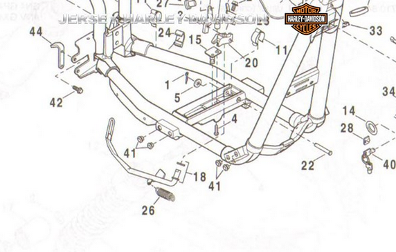

Well guys this is unreal, been trying to track down a slightly uncomfortable vibration on my ride, well I finally found it and all is fixed, it was the rubber that is attached to the frame to stop the jiffy stand touching the frame, it somehow moved up, maybe when I lifted the ride, who knows, anyway rubber back in place, jiffy stand not touching frame, and vibration gone.

First, check the engine isolators, they can 'look' good but not always are they so. Double check your clearance between the rubber of the isolator and the engine bracket.
Second, change out those sad rubber riser bushings for either solids or poly bushings; those things are the worst. I'm running a Predator front engine mount, riser extensions, and solid bushings and can ride without any issues for hours, the vibrations are exactly how an HD should feel...

Cheers TinCupChalice, now that is really interesting, I also have a 2013 Fatbob and looked at the Harley notice you posted, I looked at the Jiffy stand Pin and mine is the opposite way round from the Harley installation Manual, now is this the correct way that they are talking about in their notice, or should it be as in the Manual.
