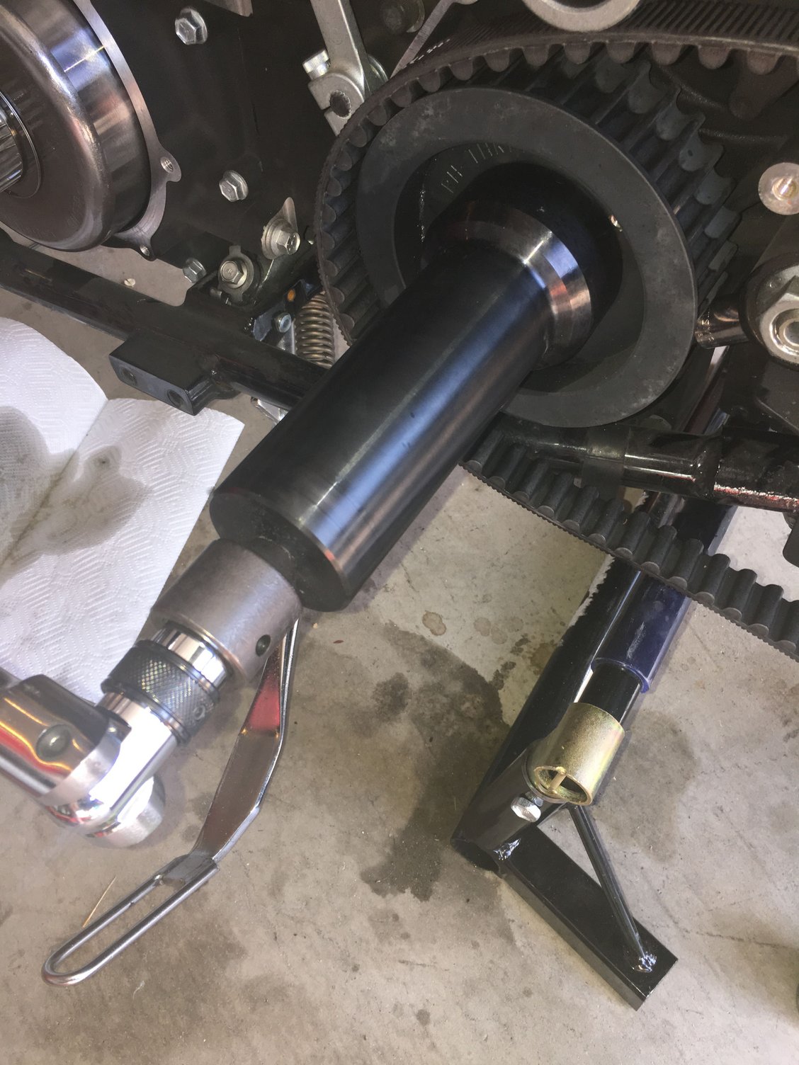

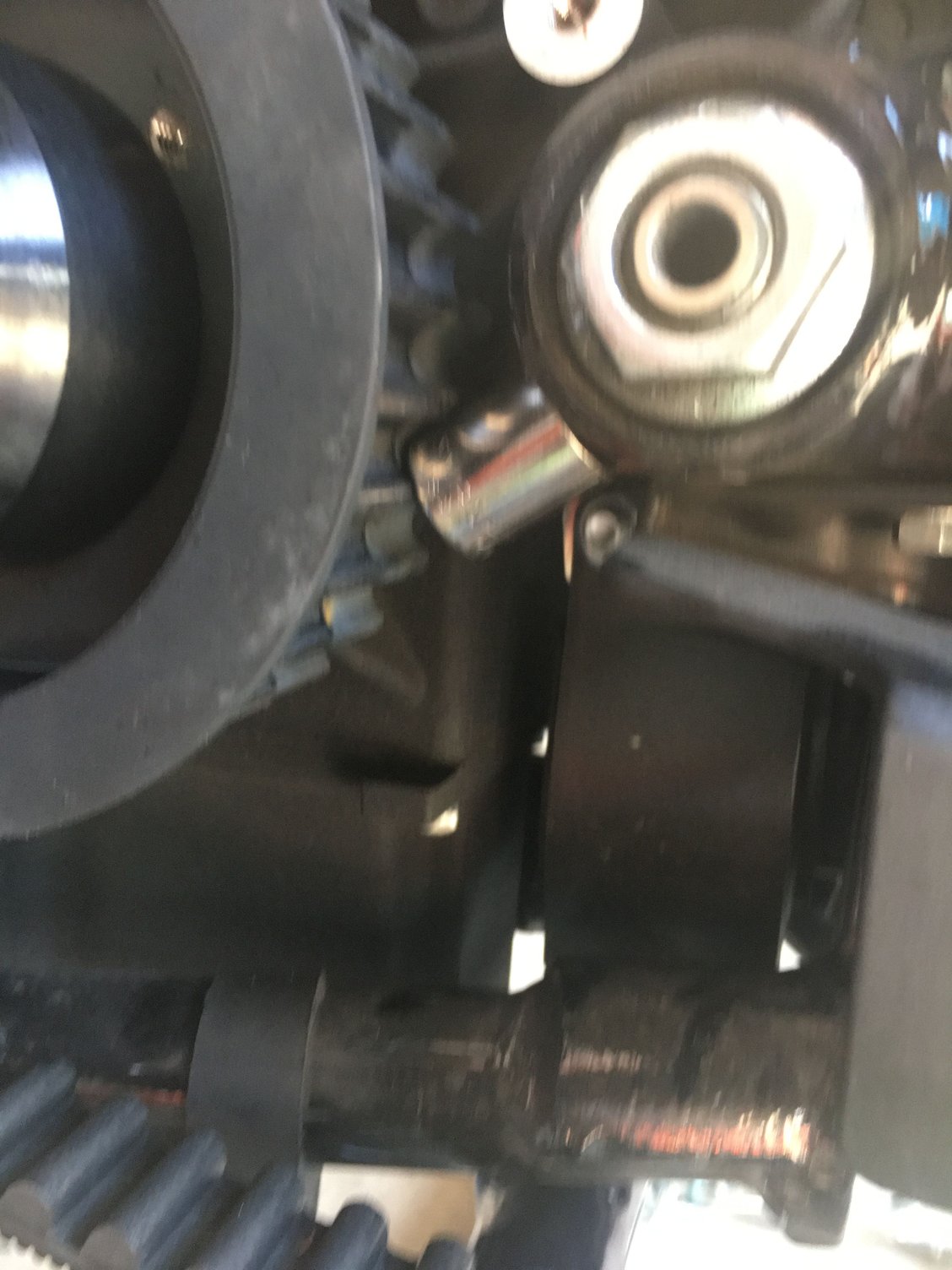

I just completed the 30/70 pulley swap on my 14 Wideglide. Based on what I read here, I knew the tranny pulley was going to put up a fight. I had ordered a special pulley nut tool from eBay. Once I got in that far, the nut didnt budge with my HarborFreight impact. Proceeded to try the 1/2" breaker, and broke that off in the socket. Ran down to HF, got the 3/4 breaker with adapter sockets. Jammed a socket between the pulley teeth and swingarm pivot. Pulley nut gave up quietly.

That nut is a bastard. Nice trick with the socket. That work to tighten it though?

It did. Need to put it on the upper side obviously. Also moved it inboard as much as I could. My belt rides to the outside and didnt want to mar the pulley surface. I looked at it when I was done and it didnt leave a mark.

Left is tight right is loose... Reverse threads.....

If you're referring to the OP's photo, I think it's an "Image Processing" issue and Not representing the "True" Lettering
Both my 2013 and 2016 Dyna Manuals indicate RH threads ...
EDIT: It may be as easy as saying BT 6-speeds are RH and 5-speeds are LH
