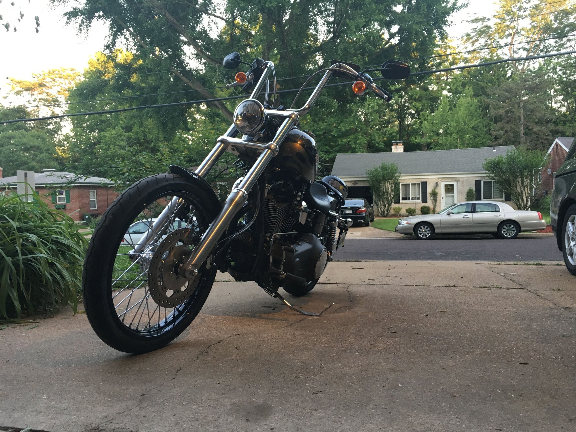

Below is my Dyna, it's a FXDWG that's running Custom Cycle Engineering fork tubes part number "T 2015HC". These tubes are advertised as 2 inches over a standard Wide Glide, and 4' over a standard FXD*. I found at 29.5 inches long they're actually more like 2.75 inches longer than a standard Wide Glide tube (stock is 26.9 inches). So if you buy those tubes and put them in a set of Wide Glide trees on a FXDCI, this is what you'll get.
like the look I wanna find a springer front end for my 17 WG will maybe a little over stock length but about the same rake
