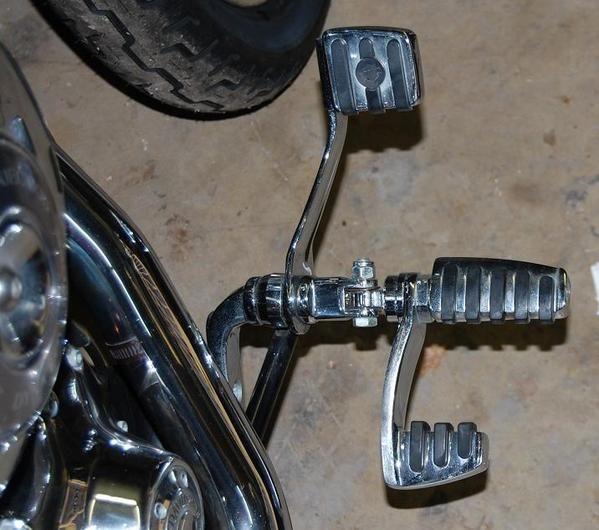

+1 on seat OR, new pegs with a heel rest... I had 'em on my Street Bob and they are awesome!

I was able to adjust the rods on my Sporty but this on is fixed, not adjustable. I have a similar set up as the one Honey Badger shows in his pic.

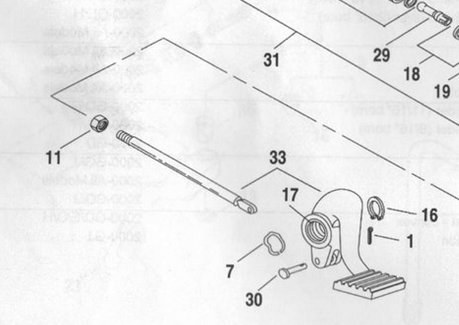

Correct me if I am wrong are you saying you have no jam nuts to release at the rear caliper on the brake rod like in picture posted below.

the nut, item 11, is all the way in, will not shorten. I am leaning towards relocating the brake bracket back 2" and then shortening the rod at the peddle end to match. I'm short so need to improvise where I can. this forum is really helping me out, so thanks.
