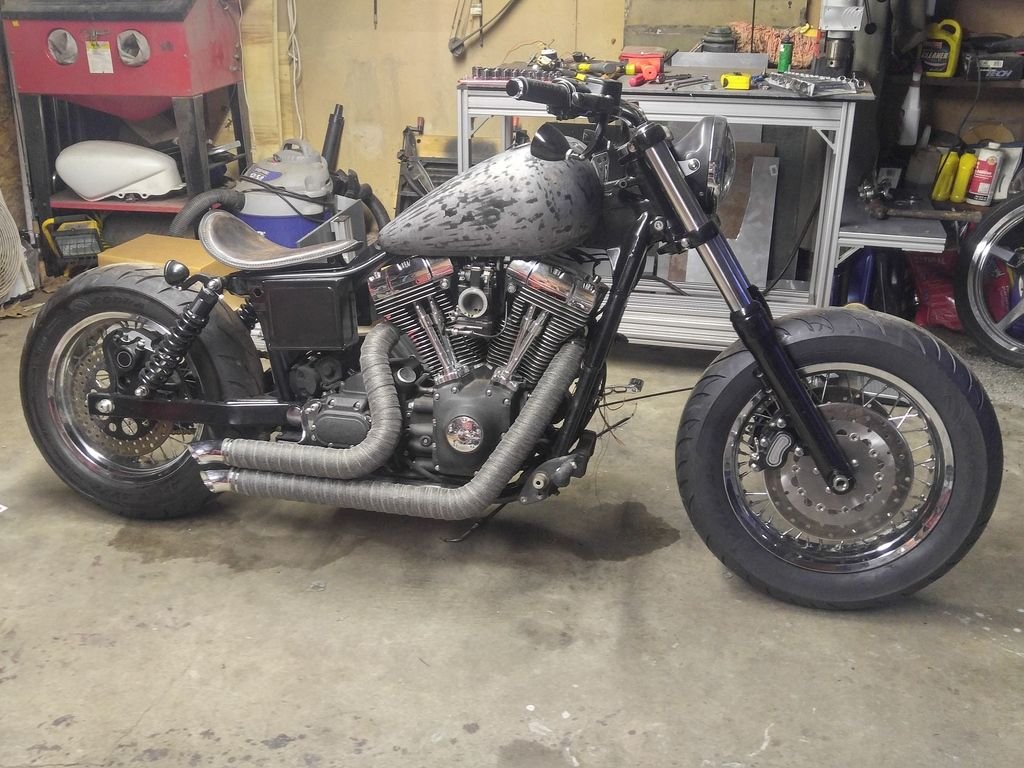

Can I see pictures of your bike, I'm about to do the same to mine, but I wanna compare the look of a few different sizes before I do

I'm still working on it so this is the best I've got right now... 180/70-16 in back and 150/80-17 in front. Slightly taller than stock ride height.
