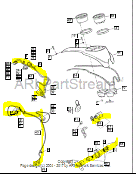

for the street bob gauge and idiot light only console:
swap out harness(s) and the console. then elongate the ignition lock wires to keep your key in the same location if your bike uses a key.
for a ignition lock, guage, and idiot light console:
swap to a non-lowrider harness is all.
assume you want to see your idiot lights. you'll lose all the stuff that lights up in your tach....(oil, directional, neutral)
compare:
a. non-LR
b. LR
