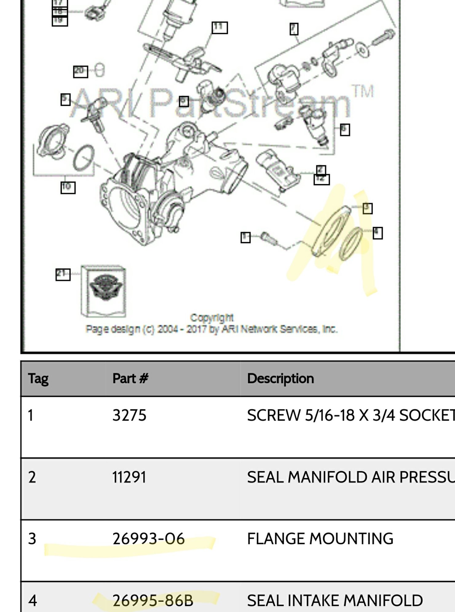

Be sure the thicker side of the seals and concave side of the flanges face (OPEN TOWARDS) the cylinder heads, not the manifold. So....
Manifold > Flange [ { ] > Seal [ ( ] > Cylinder Head
https://shop.outpostalaska.com/OEMpa...UCTION_MODULE,
doing it backwards will hurt your head and, maybe, your wallet. Been there 😢.

Hi Guys almost got it back together. Would it be possible for someone to post a clear pic of the parts page above? The bike started on both cylinders and ran a little while well before going rough. Just want to make sure I put the o rings etc back in the correct place on the fuel deliverer side.

Thanks everyone - finally got some time to look at it and its back together and appears to be running ok. Appreciate the help.
