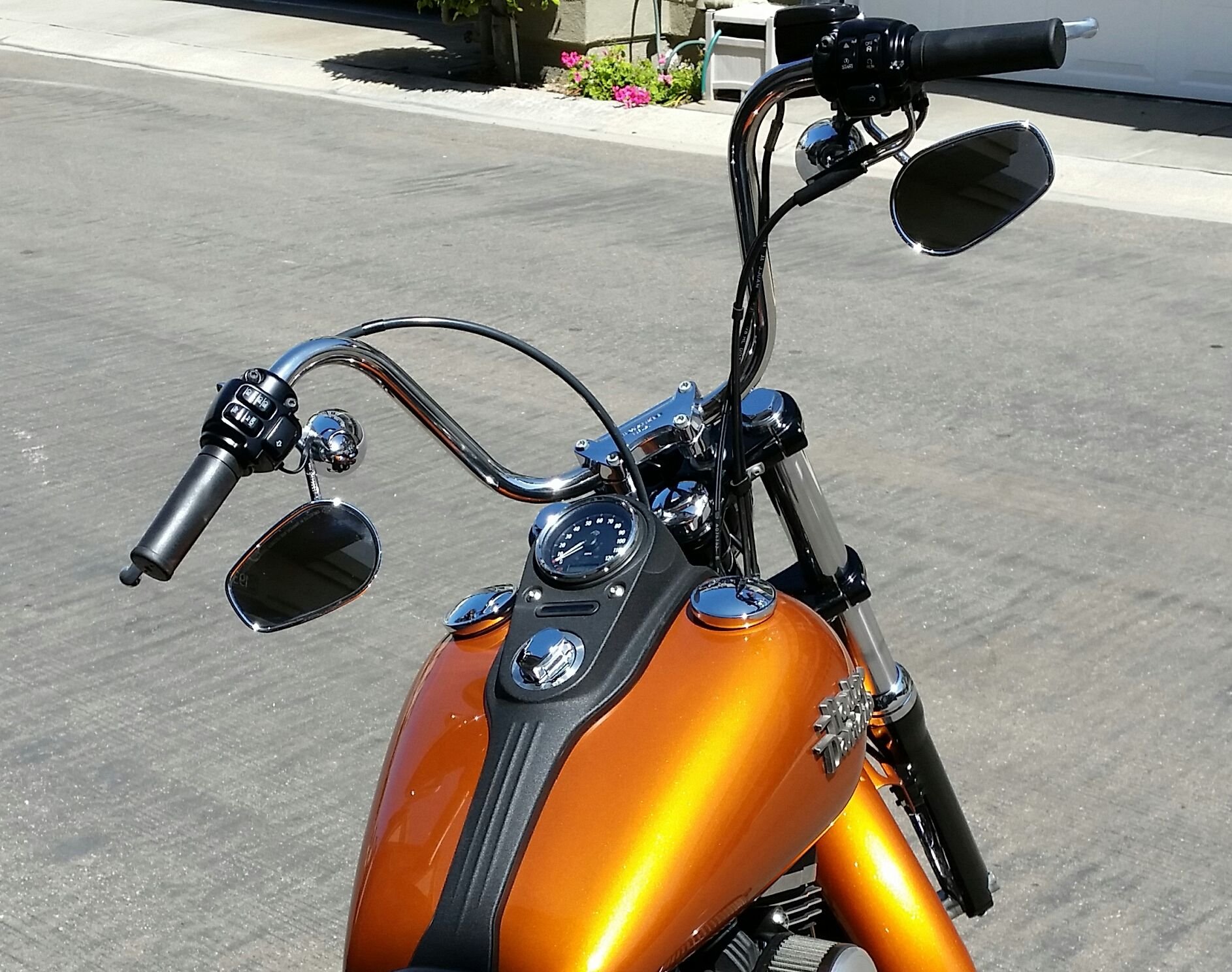

Looking to swap out my stock mirrors - but on the right side, the turn signal screws into the bottom of the mirror bolt. A lot of mirrors (Performance Machine for example) have bolts that screw into the bottom of the mirror, as opposed to the mirror having it's own stalk. Is there a kit or something that allows me to screw the turn signal onto the bottom of a mirror that does not have a bolt coming down from it?

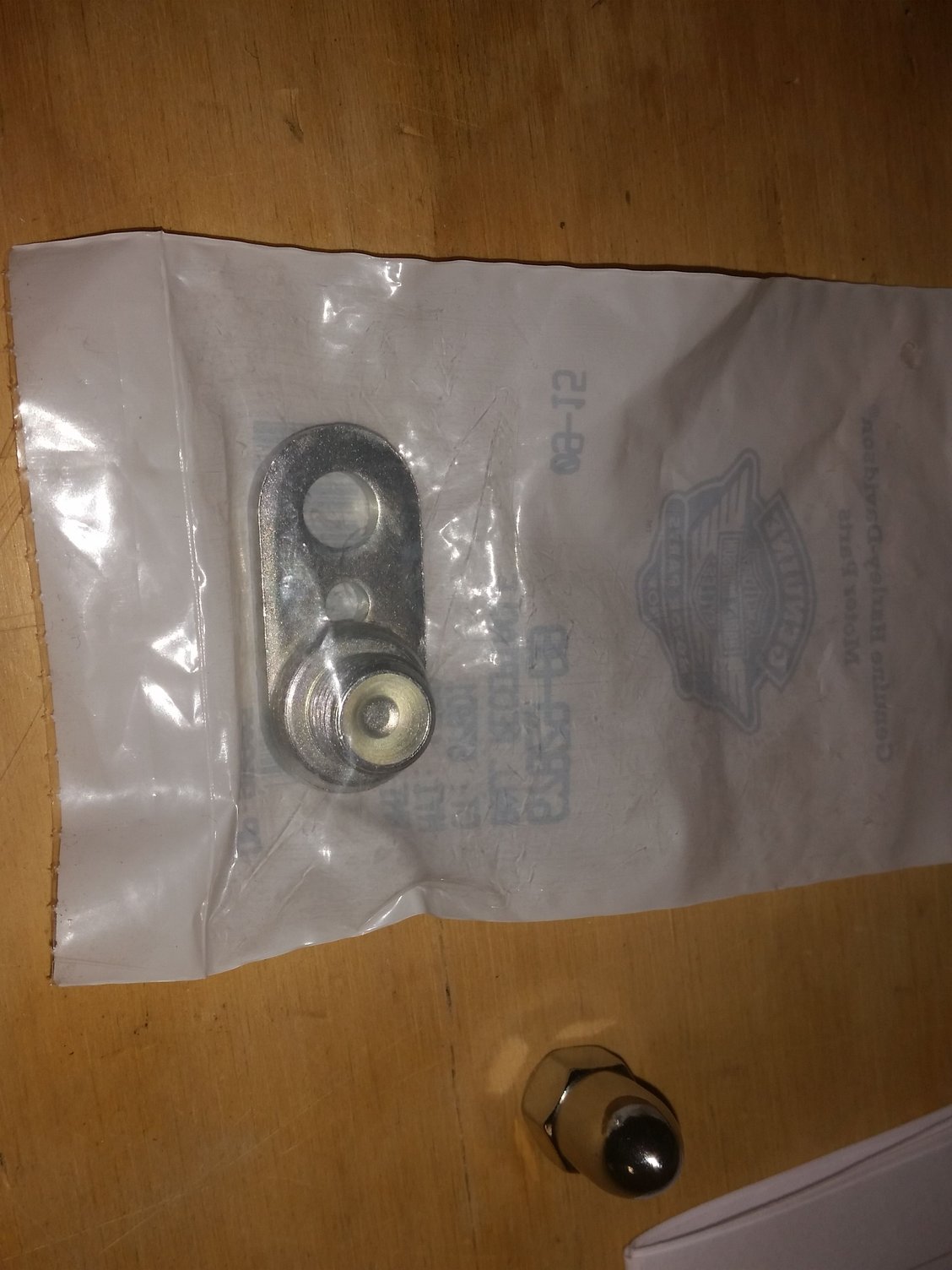

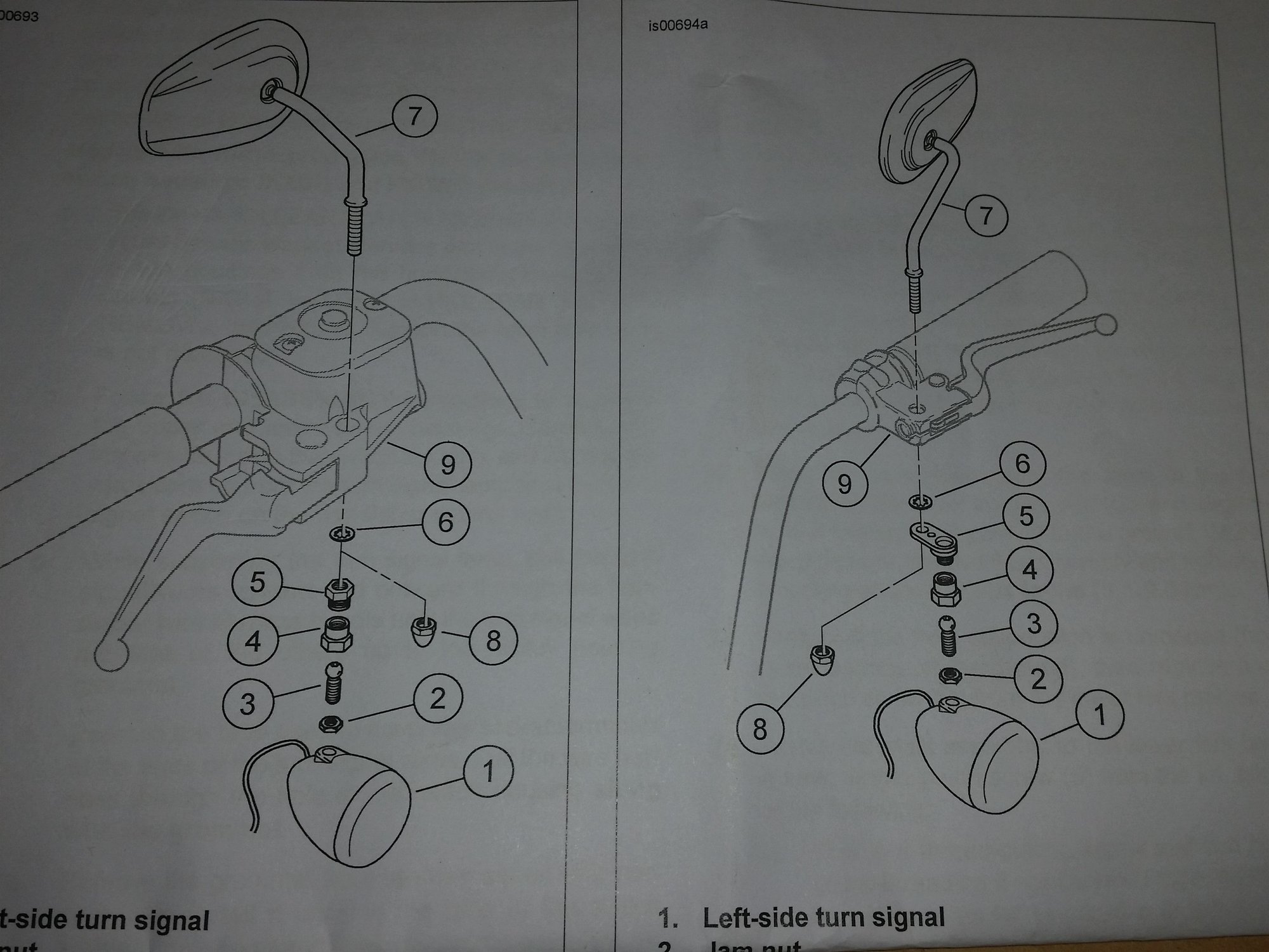

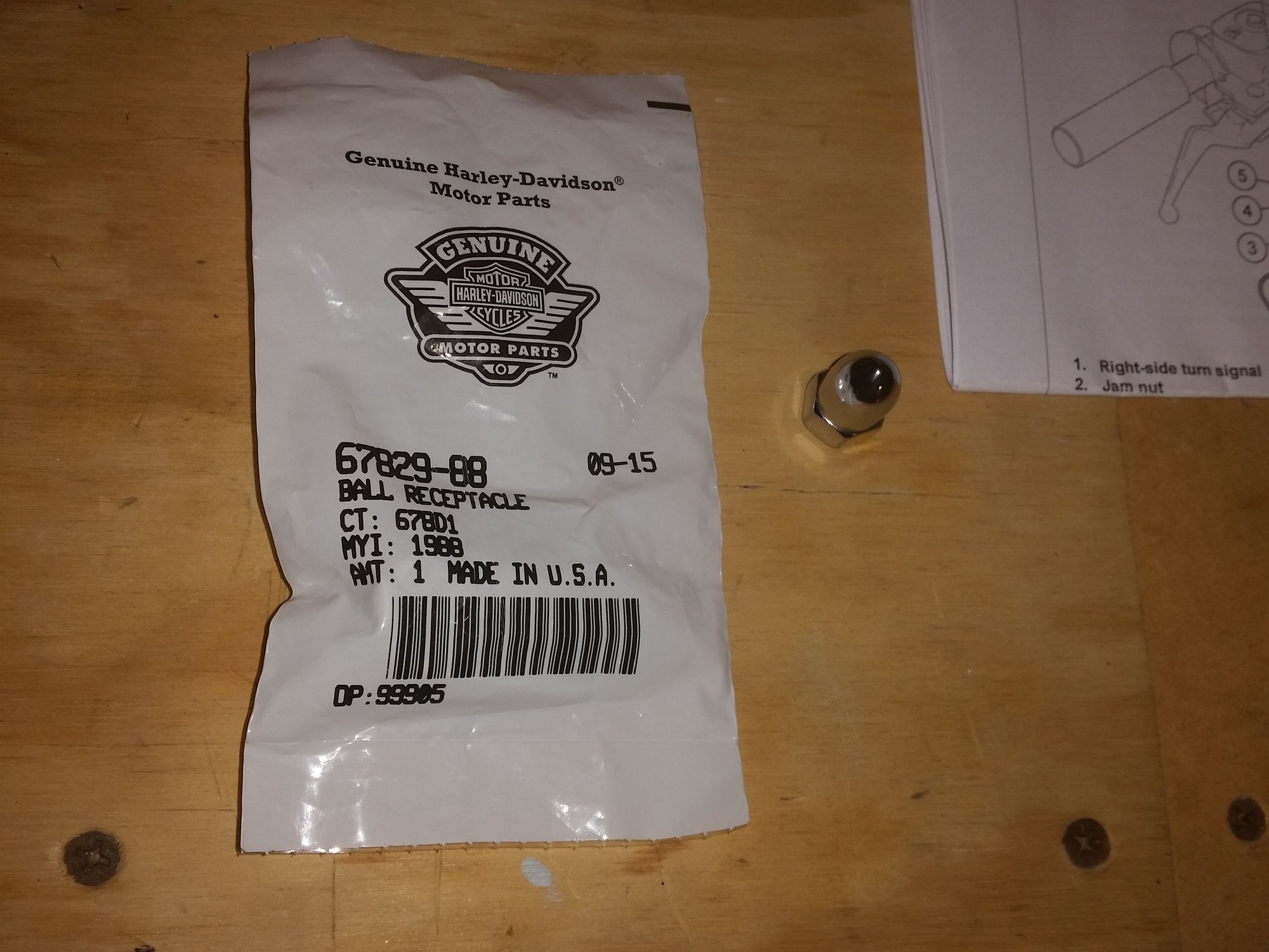

You mean like this?
I just flipped my stock mirrors, not sure how it would work on aftermarket mirrors but I just picked up an additional bracket like the one on left side.
This is the part I purchased from HD, I think it was like 5 or 6 bucks but made the process really easy.
Wow it's been a long time, I almost deleted those pics from my phone several times, glad I kept them, hope it helps...

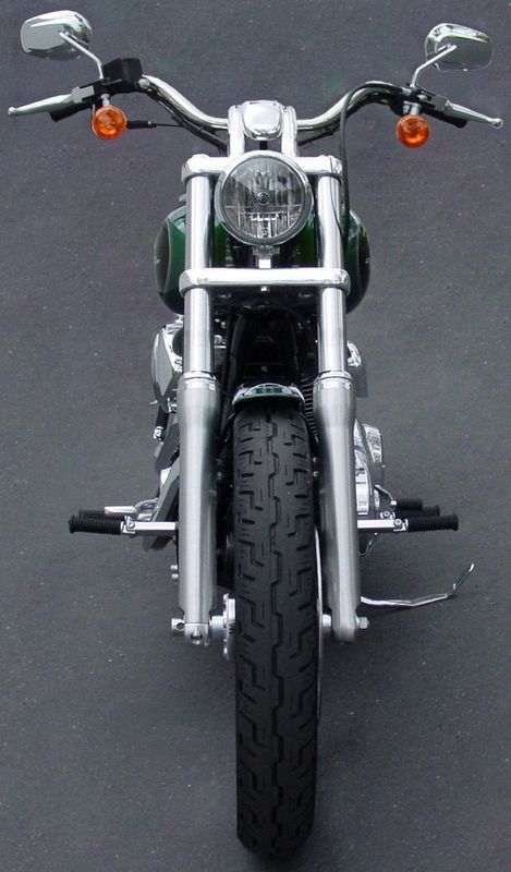

Screamin Eagle Dyna mounts P/N 68266-03 will work, and will also tuck the signals up.
Original mounts
