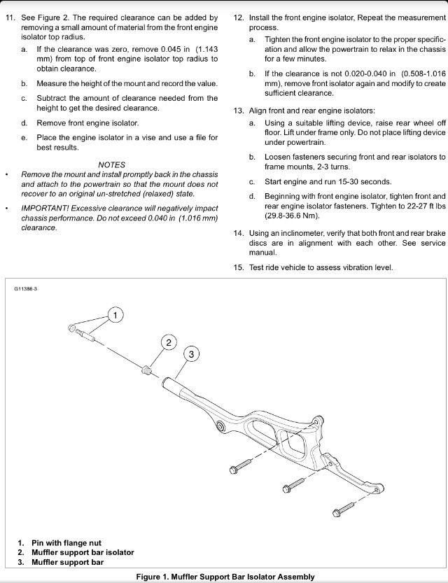

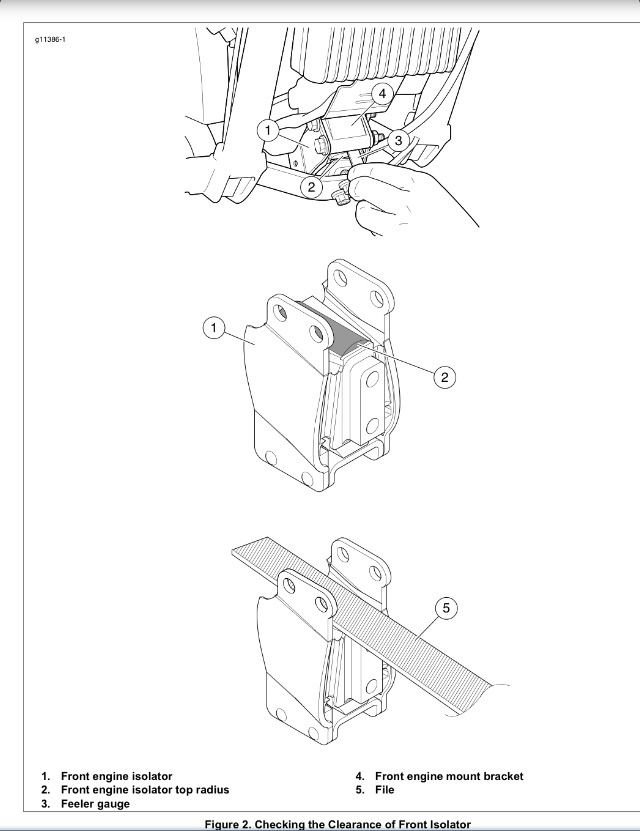

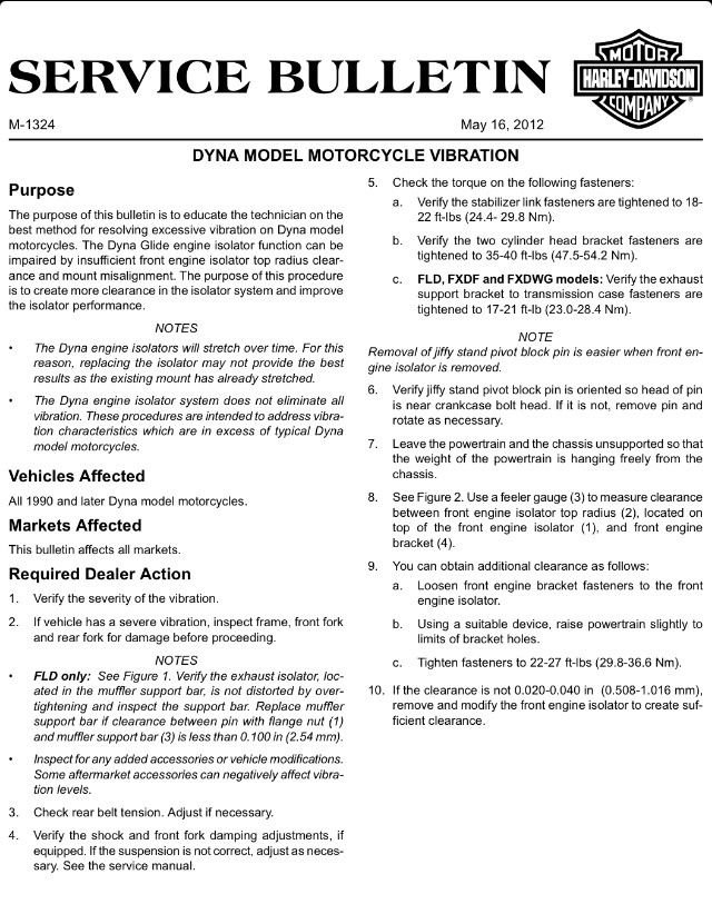

The front isolator is a wear item, sometimes they last, some times they don't. They will degrade rather quickly due to poor vehicle/engine alignment and oil contamination from oil filter removals.
Check your front clearance between the rubber of the isolator and the engine bracket.

The Dyna service bulletin so you can see how to inspect the front isolator. I feel simply cutting the rubber of the isolator is just a bandaid solution. There is a reason many of us in the Dyna forum are running aftermarket engine mounts
