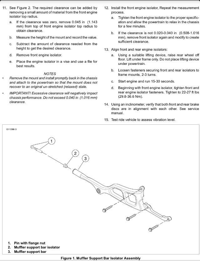

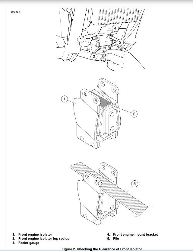

The OEM isolators are not exactly optimal. The front can fail easily due to poor vehicle/engine alignment, and oil contamination from oil filter removals will degrade the rubber isolator.
Are you experiencing any decel shuddering? First step is to inspect the isolators; if the front isolator is contacting the engine bracket that would explain your added vibrations. If your front is distorted or oil contaminated it should be replaced. HD did release a service bulletin on Dyna vibrations but their 'fix' is just a bandaid.
The only 'real' permanent fix is to consider the Predator, Sputhe, or TrueTrack engine mounts. Once installed, and the bike properly aligned you'd be quite surprised how civilized and well handling these bikes can be.
This is the service bulletin. Check out your front isolator and determine if it's starting to distort, from there we can offer up suggestions...
