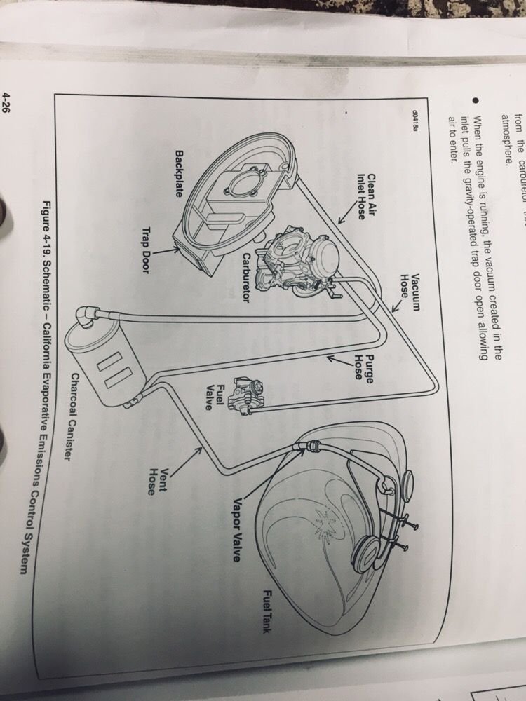

Like this one shows?

There is also a little diaphragm in the fuel valve. If it has a small hole in it, it will drive you crazy because the vacuum can't hold the valve open enough.

After looking at that diagram, I looked at my bike. Then I looked at the diagram again and thought WTF... None of these hoses are on my bike.. The I saw at the bottom of the page California.. And there's the problem! Don't use that book..

My wide glide was not a California model either. Neither was my son's sportster. They both had them. The difference in the picture of the Cali bikes is the canister. Mind did not have that.
edit. There are many bikes that have been converted to a regular pingle petcock fuel valve. These no longer require vacuum to open the valve.

😂 you don’t have the vacuum petcock?
LOL! My 99 was a California bike. The original owner stripped off all that crap. He put on the Pingel and Mikuni. Good thing they don't test. I took off the vent hose and check valve. It's just a big hole in the top of the tank now. Don't tip it over!
