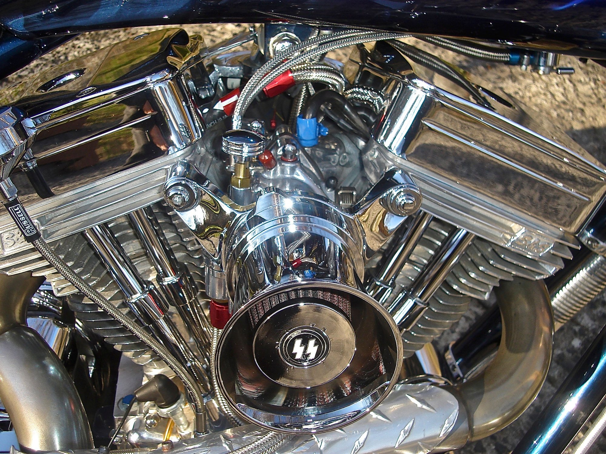

MY 117 C.I. S&S powered Engine with a BAKER 6 SPEED 530 Anodized Chain Driven Driveline - Transmission Sprocket to Rear wheel ( 23 Tooth Countershaft
530 chain Sprocket to a rear wheel 48 Tooth STEEL Rear wheel Sprocket) the Bike in the picture I'll provide - and I have to admit I'm an S&S Dealer and *A* Tech Graduate of their Engine School ) is cranking out 141 HORSEPOWER and 148 FT POUNDS TORQUE and runs low 10s @ 139-to 142 MPH in the 1/4 MILE . I'ver got S&S Heads,Cams,Tappets,pushrods,tappet Blocks on an ENTIRE S&S Factory motor .my Bike weighs in at 126 Pounds and has a bunch of *Lightweight* "jenny Craig* parts......but this season we'll / I'll be running High 9s with this STREET
Beast
Low 10's, high 9's?
With what bike? The bike in that picture would be lucky to get in the 11's-You are gonna need more than 140 HP to run those numbers with that chassis, steamroller tire, and bike weight.
If you are running 140 mph in the 1/4, you are making at least 170-180 horsepower....
Who built your motor and who did your heads?

Originally Posted by VS Custom Cycles
I Built The Motor and Did the Headwork after the entire Motor was blueprinted and tweaked with special crank,rods,Wheels and other "trick Items" available to an S&S Dealer like myself on the *SA* Program ( Special Applications).on this bike .Its alot lighter NOW than the pictures( newer ones to come shortly ) I Went to S&S School and also MMI and I'm a Machinist & Drag Racer. This bike does exactly what I wrote & quoted and I'd be more than glad to give you details if you message me .My 96 C.I. S&S MOTORED 1989 FXR does High 10s all day long . I've been at this awhile,and at 36 I've got alot more tricks to race these bikes into "happyland' 1/4 mile times by reducing more weight,and refining the motors within spec to their C.I. realms . I also weigh only 128 pounds and thats an added factor to help when doing 1/4 mile times and a lighter bike . Message me anytime and I'd gladly speak to you about these topics .
Sounds amazing-
Is your bike a daily driver or a full drag bike? Does it run on pump gas? No wheelie bar or nitrous?
Please post up your high 10 second slip with that FXR and a low 10 slip with your current bike-or video of the bike running the number. Love to see fast Harley's doing their thing....
Let's keep this right here, not on private messages. Everyone can learn about your bike in public, as I like keeping everything in the open, no games.
I have been at this awhile as well and my FXR with a 96" motor ran an 11.88 at 116 mph over 15 years ago, so apparently your 96" FXR would blow my old bike away.
My current FXR is a little bit quicker now, but with your bike now in low 10's and gonna be in the 9's, I guess we would have a close race....
Would love to run your bike if it's a real street bike....
