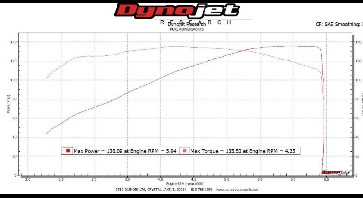

To get back on track a competent Indy builder/tuner will get you to 130+ harleys kits don’t compare to the aftermarket
O and that thunderheader will prolly hurt you if you’re aiming for max hp numbers
Here’s a 117 the builder/tuner I will be going to this winter just did running 10:8 compression fueling 594’s with matched headwork and hpi 58mm throttle body and a propipe ho (dyna)

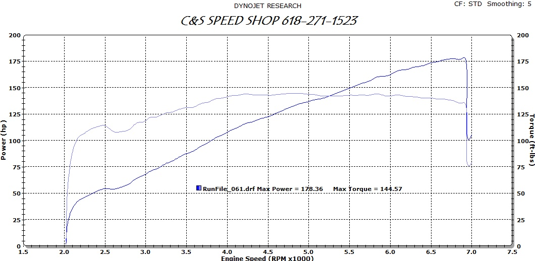

That's next on my list after I finish my lrs. Gonna take a while due to finances but I want to do a 124 wide glide. Lol Then maybe I can do high 9s at 140 mph at a weight of 126 lbs and be an s&s dealer and hijack threads to brag. Sorry, I had to.
178hp/144 tq is nothing to shake a stick at.
