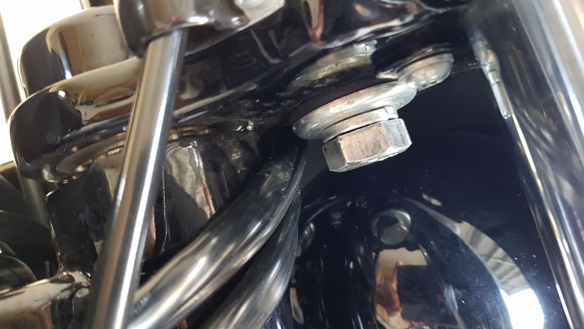

G'day All, I've just put some risers on my low rider s and now the dampers seem to flex heaps, the bolts are tight so I'm guessing that the extra weight and leverage is too much for the rubber, does anyone know if this is normal?

stock bushings don't like tall bars and increased leverage.
go solid:
https://www.revzilla.com/motorcycle/...ngs-for-harley

Installing polyurethane bushing will help. Increased height, increased leverage/strain, just the laws of physics.
Welcome to the Forum.

That's good i thought i had installed wrong somehow, cheers I'll get some polyurethane ones, thanks for the help.
