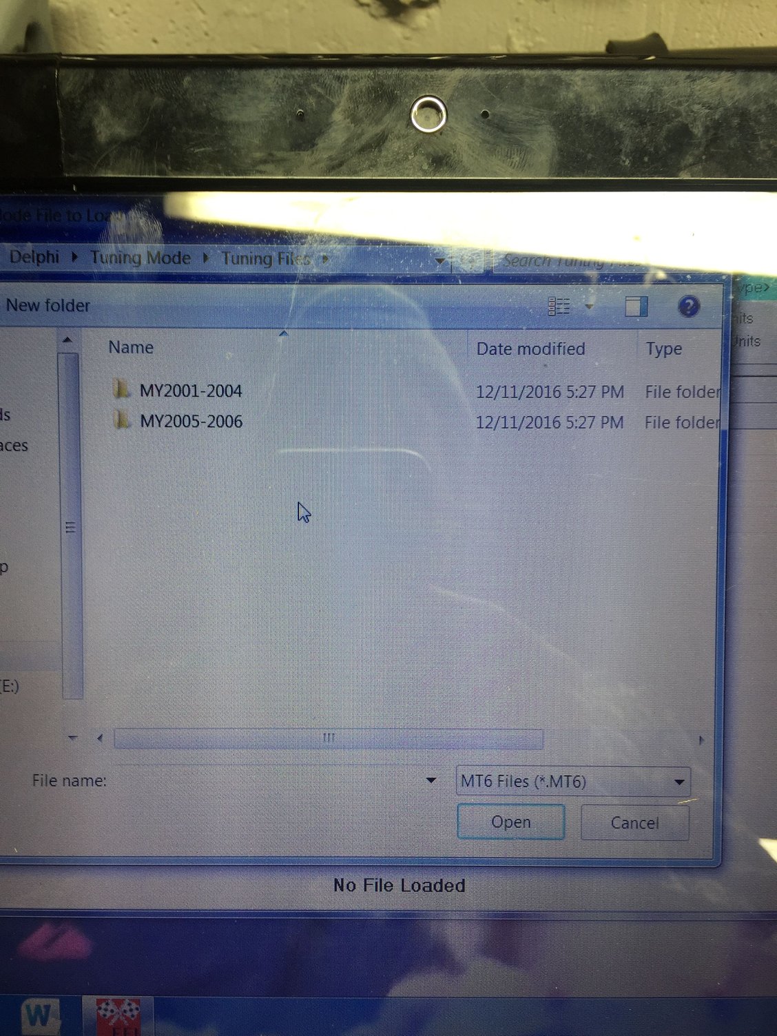

So after several times of trying to disconnect and reconnect I got it to open. The only file choices I have on the software are shown below. I picked one for an 06. I clicked GET ECM DATA and then PROGRAM ECM. Then the second window popped. Maybe my earlier hunch was correct. I need more recent Files?

You might need to run that old of a version in compatibility mode for Windows XP to get it to run on Windows 8 or 10

On the icon where you launch the program, right click it and left click properties. There should be a Compatibility tab or section. In there will be a label that says Windows XP. Check the box next to it and left click OK. Then try to run the program. You may have to interpret those instructions a bit as I am not right in front of my computer at the moment.
