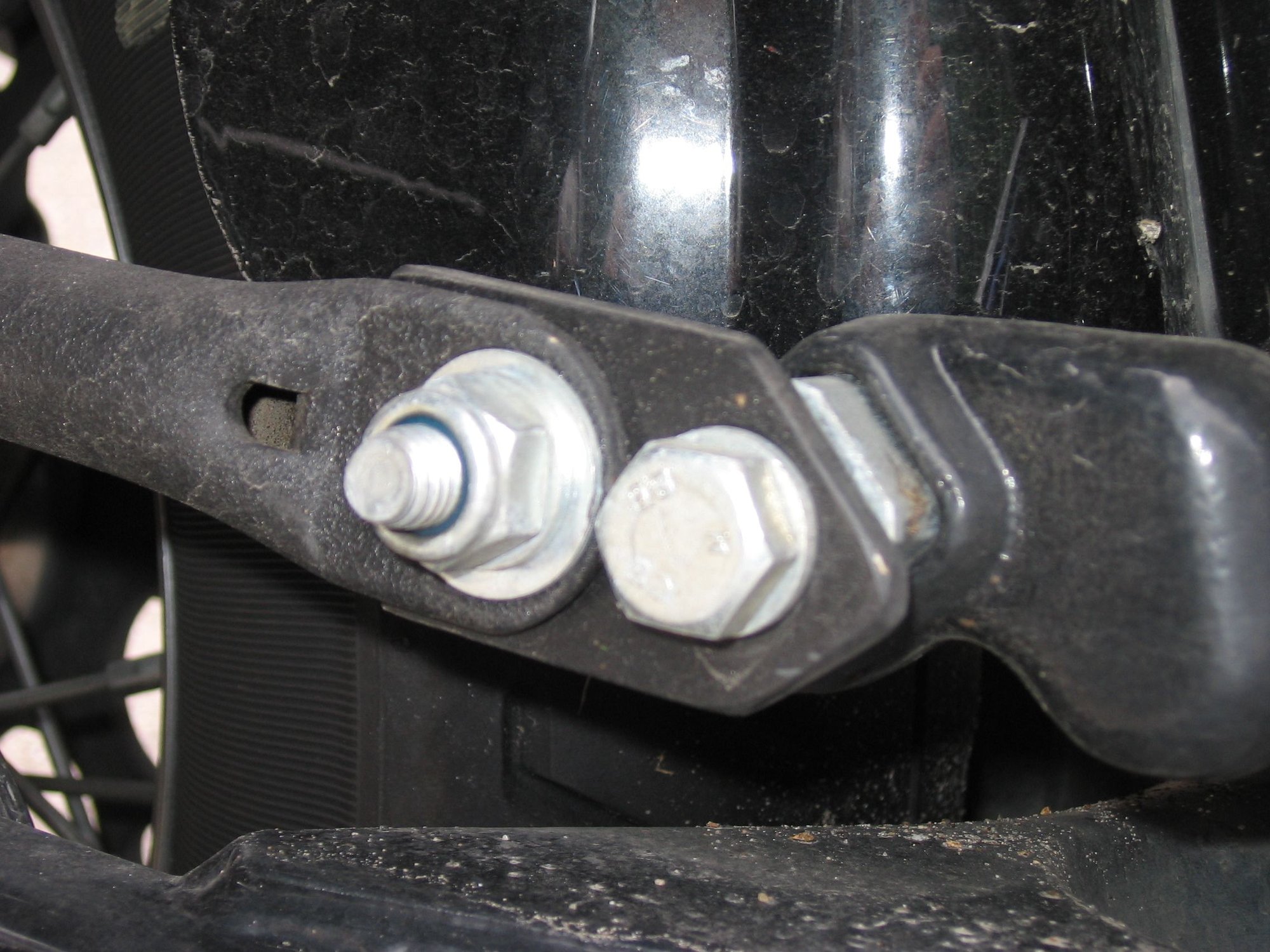

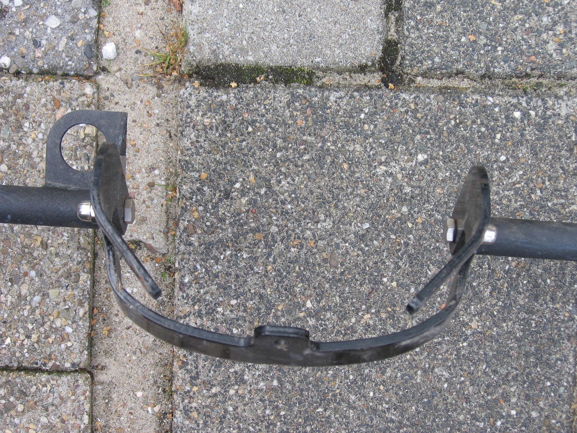

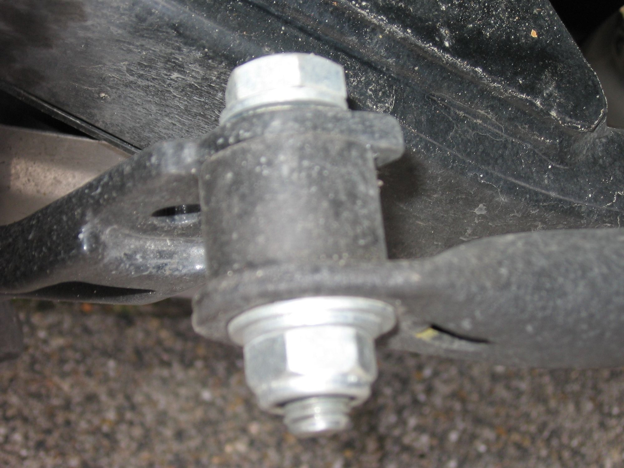

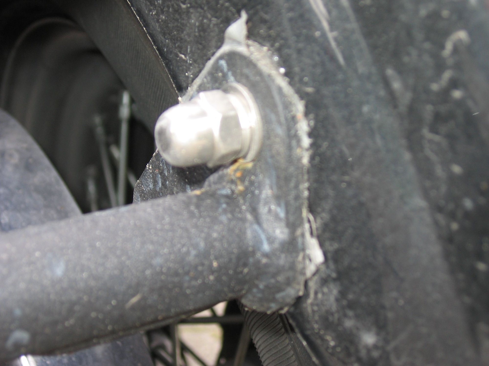

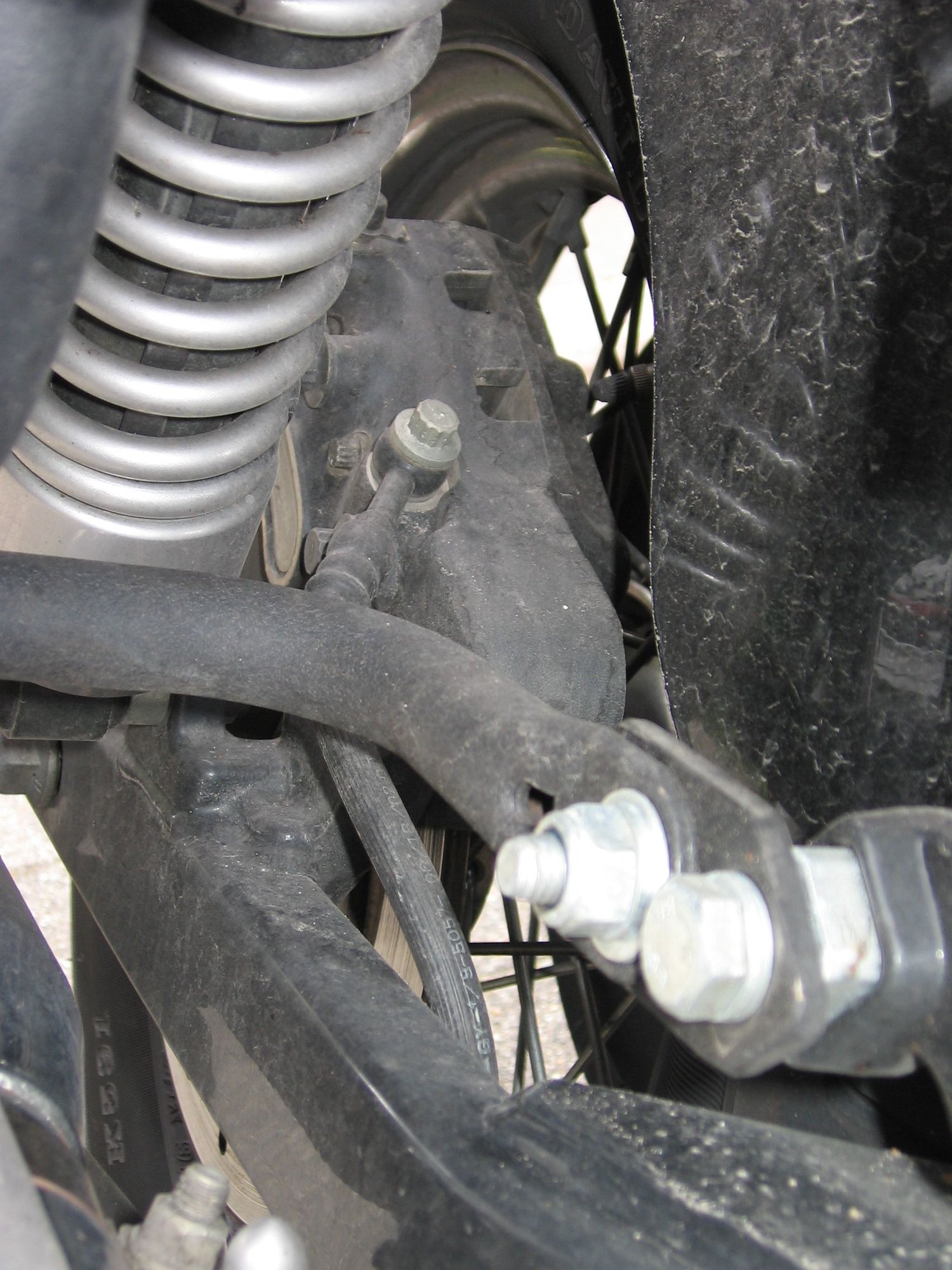

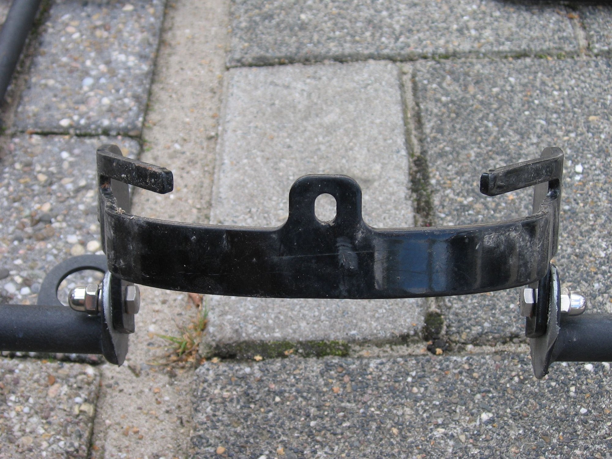

Here's what I used in 2010 to make it look like this:
L/h side passenger footrest bracket (p/n 52740-94A)
L/h side home made spacer
R/h side spacer (from fxdp p/n 58732-02) and home made adapter plate
Sportster seat bracket p/n 59673-04A (mounted inside the rear fender) to support rear mounting points
Mounting points at rear fender
