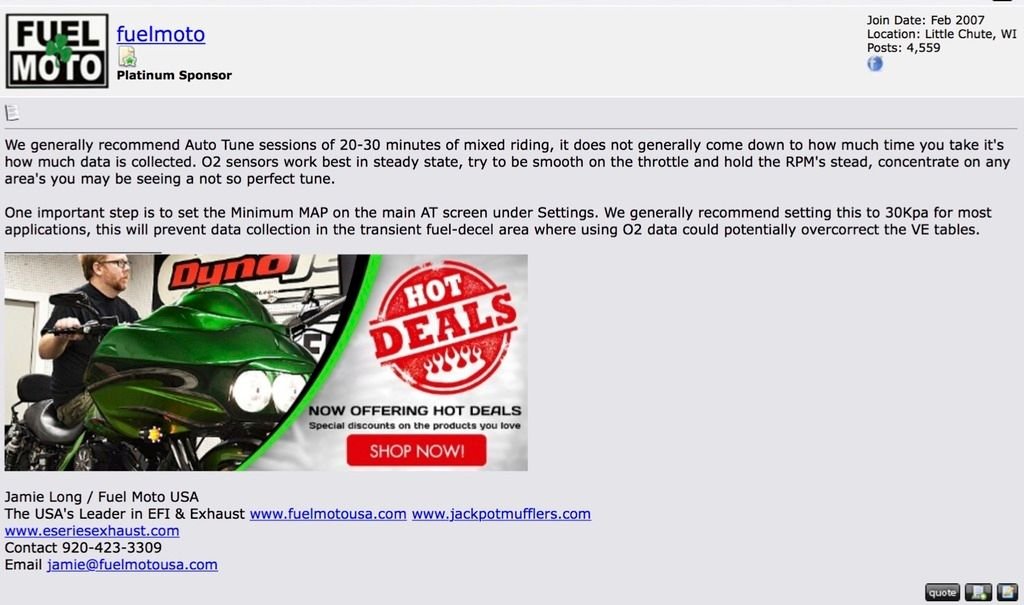

When it comes to auto tuning set the minimum MAP to 30Kpa to prevent data collection in the transient fuel - decel areas. Set up the auto tune run so you can see the data hits; when a fuel cell goes red it has collected the maximum amount of data for that auto tune run...

With the same gas I did get a chance to do 1 of the 3 auto tunes. Took a 1/2 hr run to the gas station? Wow! Did the first tune and I can hear and feel the difference already. I'll do 2 more tomorrow. I think by the time I do 2 more she'll be running like a clock. Best 5 bills I've spent in a long time. I'll let you all know after I do the others
