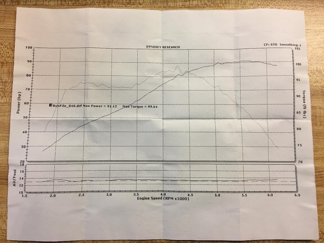

Started with a stock 07 Street Bob TC96, added S&S power tune duals, AN big sucker intake, PC5, and Andrews 48H cams. Dyno'd this weekend, custom map turned out 91.12 hp @ 99.64 tq.

Post up the graph!

Never seen a TQ curve so bumpy, unless the tire was slipping on the drum.

Interesting the numbers cross at about 4500 rpm. I thought the formula was something like: HP = (TQ*RPM)/5250
Which is why you see most dyno sheets tq/hp cross at 5250.

Good catch. Something doesn't make sense there.

Being as I haven't ever had anything dyno'd before. Your statement got me interested, and I'm all about useless knowledge. So there is a great video by an engineer that explains( through a few math formulas) how and why each number is what it is. Very interesting video
. But the easy answer is that the graph is scaled to fit both graphs over each other. the HP scale is 100 and the tq scale is 105. That would move the intersection point. Watch the video, very interesting. 5252 is the point at which hp=tq its 1 to 1. But as already stated when the graph gets scaled to fit different size scales the intersection point has to move.

I hate when they use those offset graph scales. Sounds like pretty fun numbers for a Dyna.
