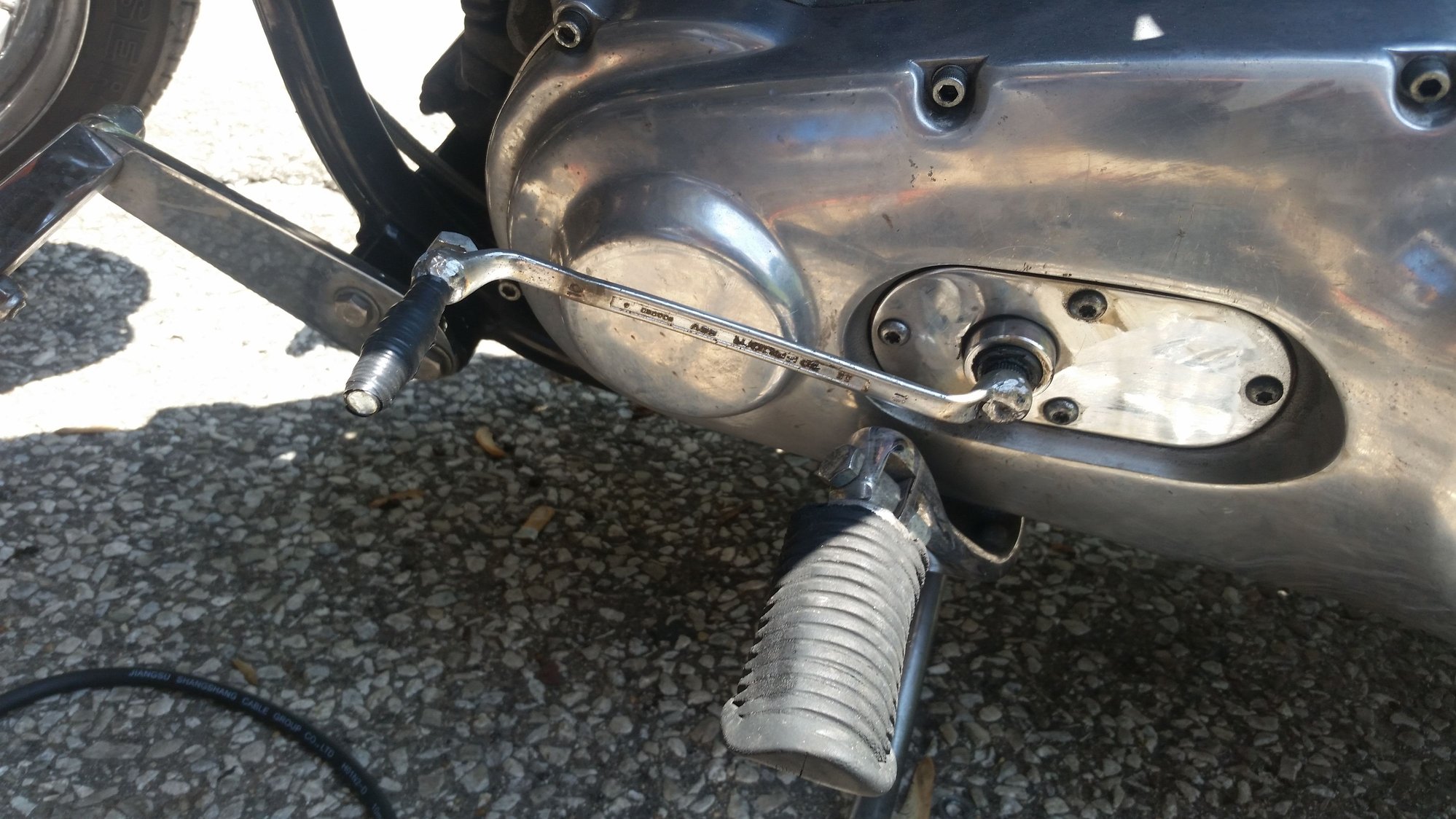

My 98 FXD ended up stripping the knurls off of the shifter rod on my mid controls on a ride a few weeks ago, I hated the mids anyway and needed an excuse to spend the money on forwards for it. Ended up shifting it with a pair of vice grips to a friend''s house and welded a wrench onto it so I could get It home. Just a sh**ty 110 Flux core weld, but it worked

There is currently a thread in the touring section about replacing the stock shifter rod with heim joints...super easy, cheap, and quick...even easier than welding a wrench to the shaft.
