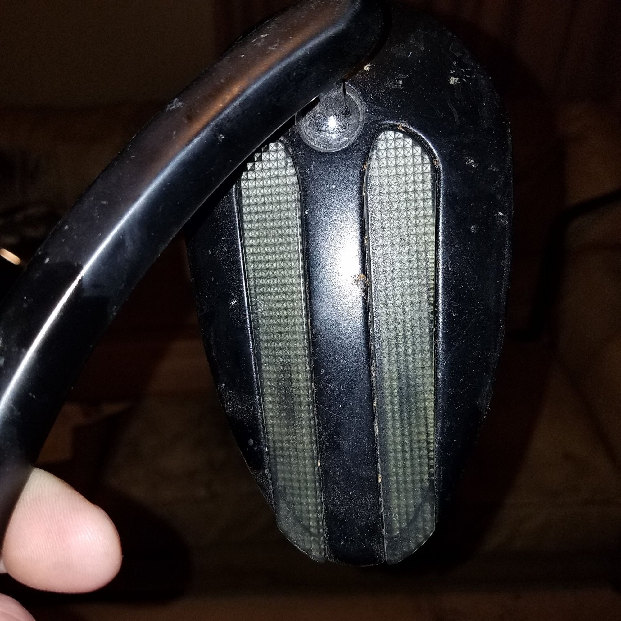

Maybe some of you can give me some advice. The bike came with the front turn signals in the mirrors. The glass popped out of the rightside from the accident. HD wants 280$ for a new set and I don't really care for them. I want to mount indiscreet turn signals on the tubes or on the trees.
I ended up cutting the left mirror/signal loose by cutting the two wires running to the turn signal.
I know that the line power for each signal goes to the corresponding switch. You then hit the switch and power flows from the line side to which ever turn signal you have turned on. I thought that my current mirror/signals also worked as marker lights that stayed on constantly but I only saw two wires. If they were constantly hot I would think there would be a third wire? I attached pics so you can see what I am trying to describe. If anyone has any insight it would be greatly appreciated.

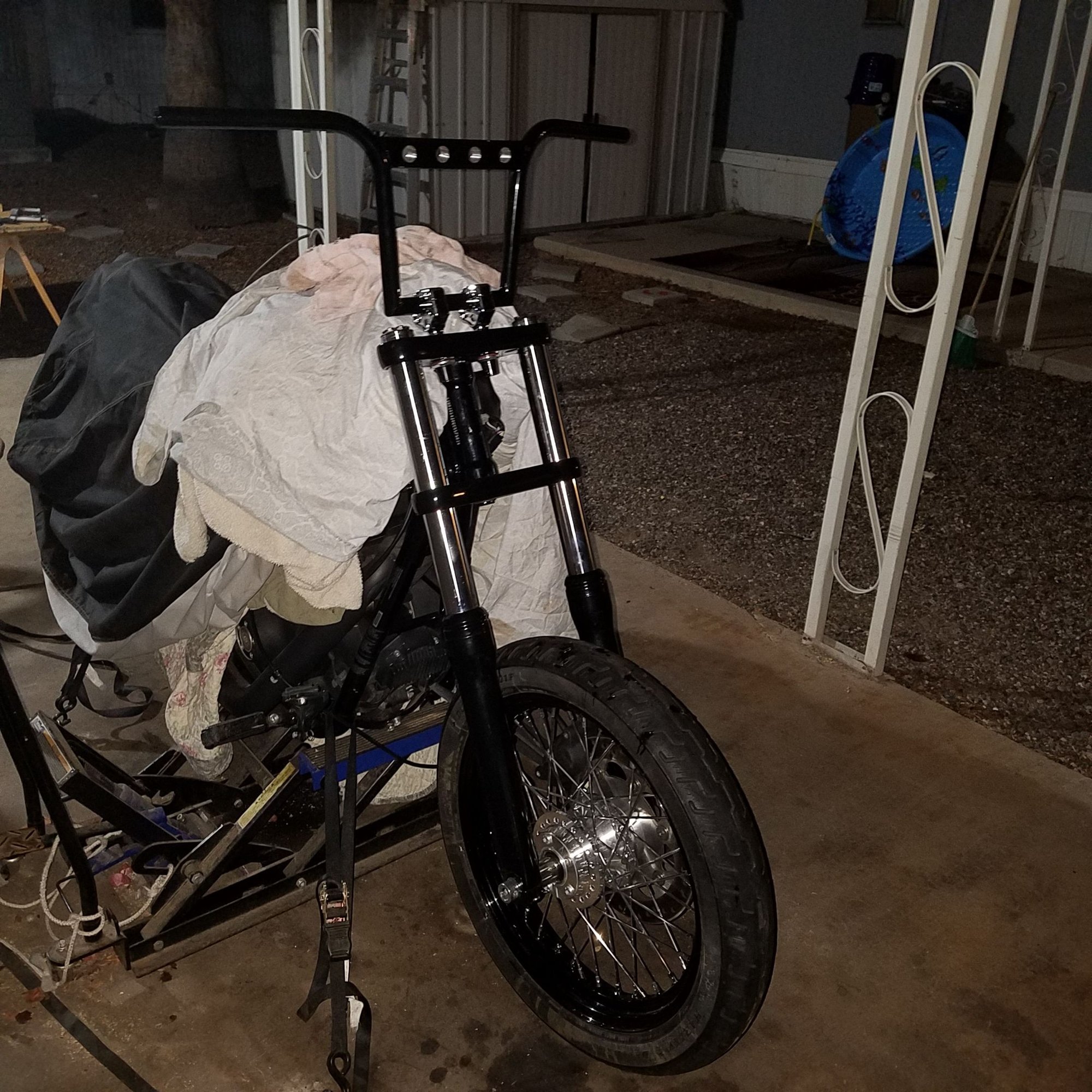

Look at those bars! I fell in love with them the first time that i saw them on one of Pete Peirson of Rocket Bobs bike builds. The funny thing is, i seem to be the only one that does live them. Screw em, they can buy their own bike and run what ever bars they want.
Mirror with internal forward facing turn signal
The two wires poking out to the right that still have the heat shrink on them are the two that i snipped to remove the mirror. They will be the two that i need to lengthen and feed back through the bars to provide power to my new turn signal. I will have to break out my meter tomorrow and start testing.
The bars really accentuate the new wide glide front end. The Joker Machine grips are going to look great on the Zombie bars.

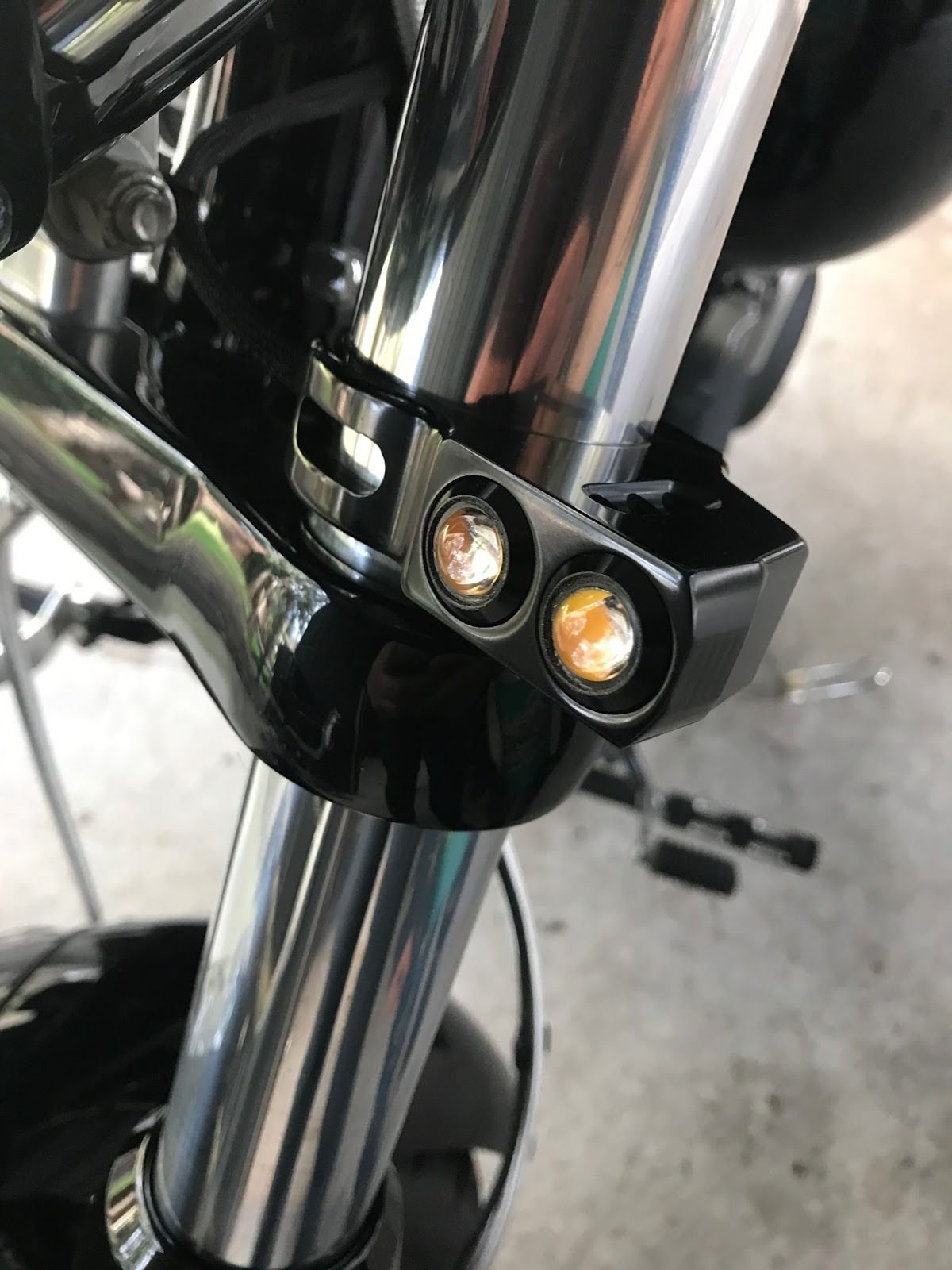

I have joker machine turn signals mounted on the fork trees, very bright an discreet enough. I would go for JM’s other turn signal option over these as I think they have better quality LEDs

I've been looking at the dual rat eyes but the ones that mount on the hand controls. My only fear is that drivers won't notice them being buried up in my hand controls.
I have also been looking at Custom Dynamics 49mm wrap around, hard mount lights but after shipping they come to 280$.
Unfortantly I don't have the budget for neither of the two choices. I think I'm going to buy some temporary 20$ jobbies until I get some of my left over parts sold and I can afford the ones I want. I had found these lights a few months ago but I saw cggorman recommended to another member in a post I came across recently. I figure they will work in the mean time.

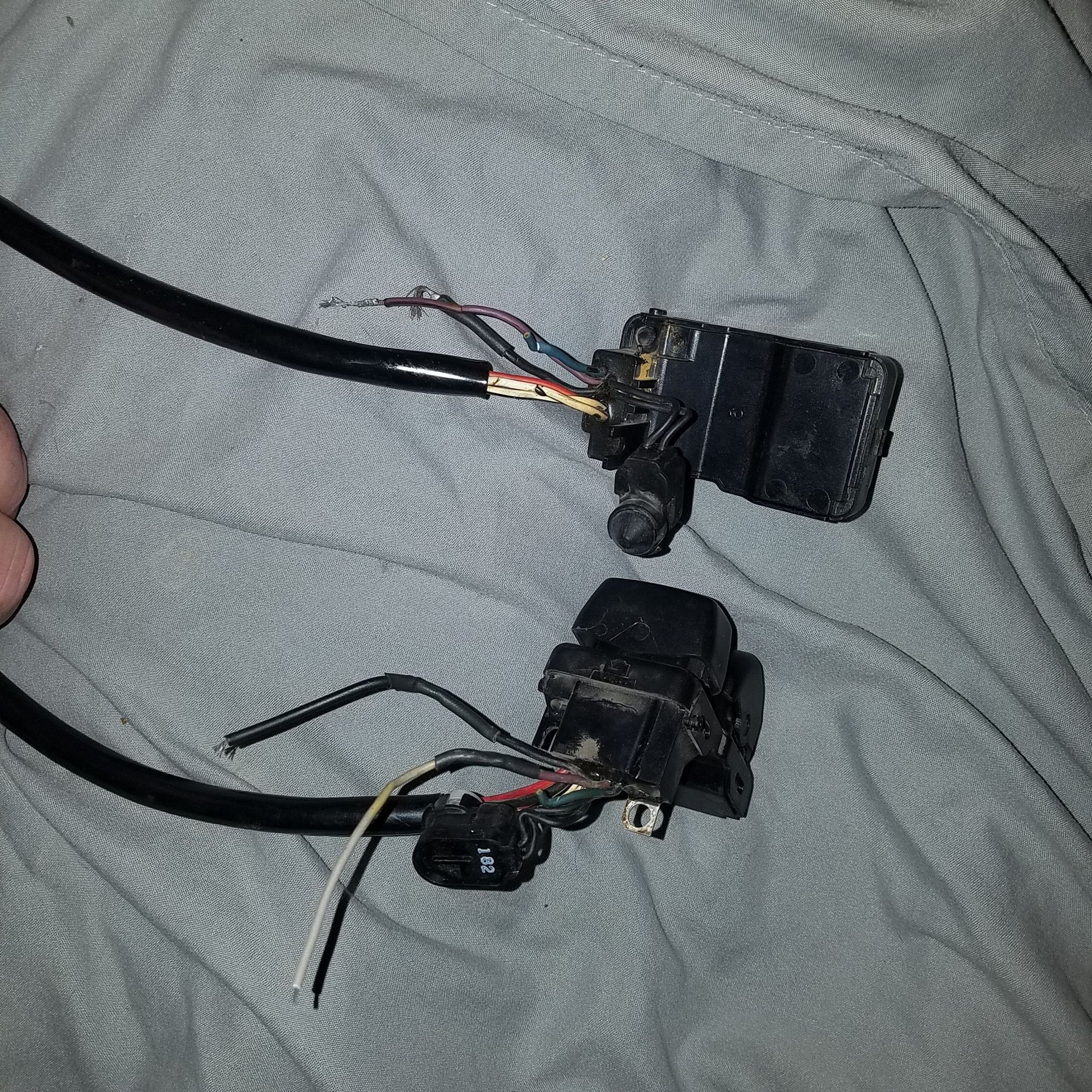

I have almost 20 years of commercial and industrial electrical knowledge under my belt but I let motorcycle circuitry overwhelm me. As a day one apprentice they start pounding in your head to rely on your electrical meter. Instead of just jumping in and metering wires out, I looked at all the many wires from a distance and let them stress me out. After 3 minutes metering out wires I found out exactly what needs to be done.
The turn signal leads run directly out from the switches. I had got it in my head that they led back to the neck first and that you had to tap into them in the their.
Here is my right and left side hand controls together. There is six wires total. Both sides have a blue and a black wire. The left side also has a purple wire and the right side has a brown wire. Black is negative, blue is constant hot to allow the signals to also run as always illuminated marker lights and the brown and purple make either light blink. That's it, it's that simple. I now feel like a fool for stressing the issue so much.
