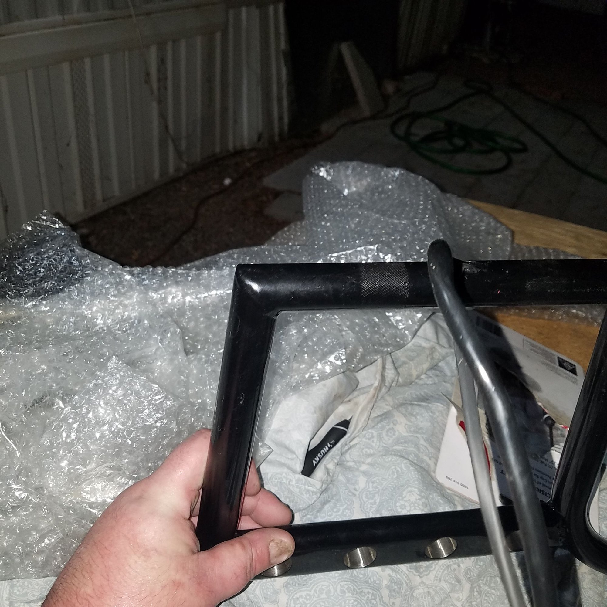

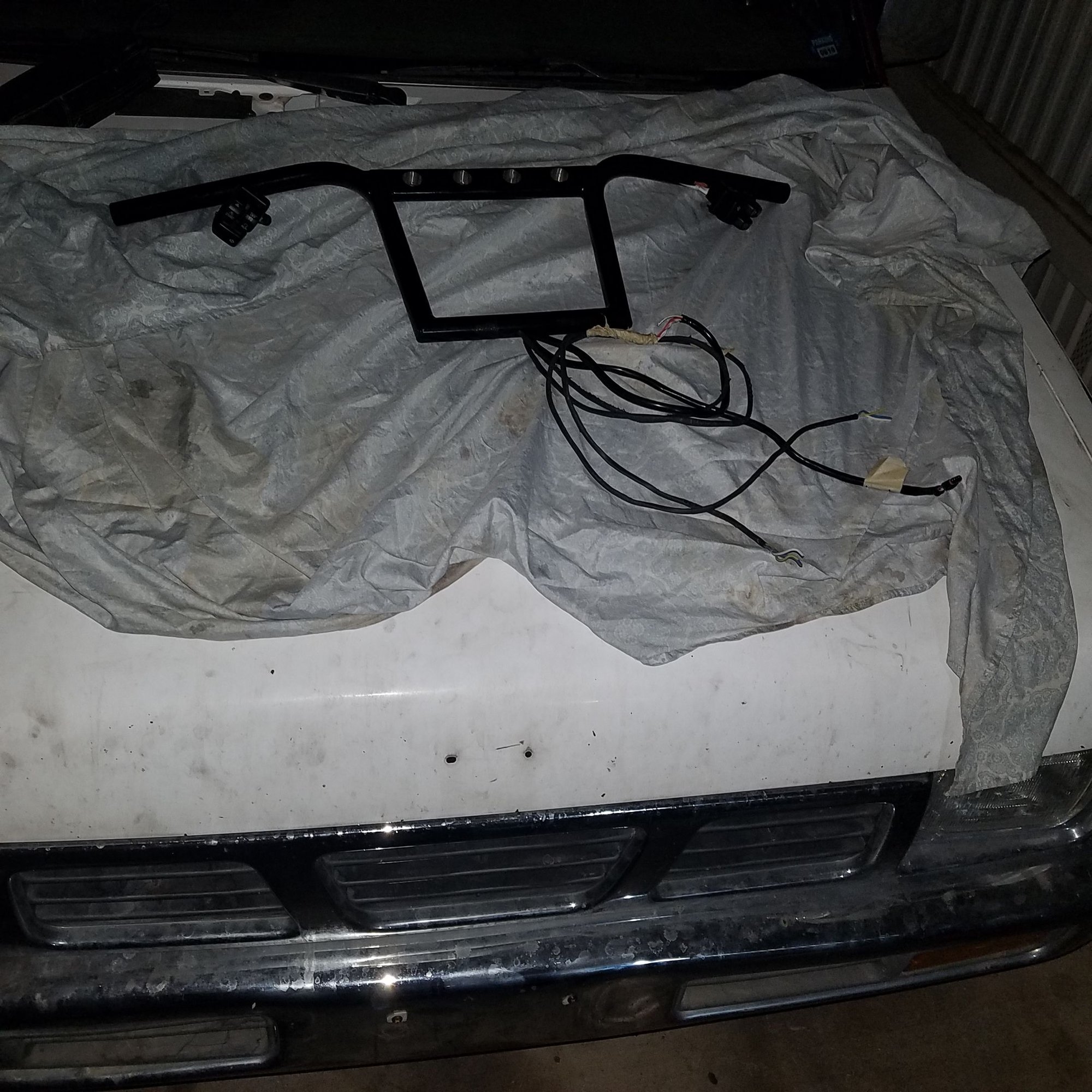

Default Wires have been snaked through the handlebars
I got the wires pulled through the handlebars. The job would have been very easy if the handlebar maker Rocket Bobs filed the inside top edges where both of the hard 90°'s come together prior to welding. Both corners were like pulling wires across the edge of a blade the entire time. I used tons of windex and wire pulling gel but no amount of lube would make the wires flow easily. The entire heat shrink got skinned up bad but I don't think any of the wires insulation was skinned. Though in fairness these are the first bars that I have done so I have no other wire pulls to compare it to but it just seems to me like filing the sharp edges before welding would ease in the wire pulling process.
Anyway, the bike is finally coming together. I am certain that the bike will be off the lift tomorrow and ridable.

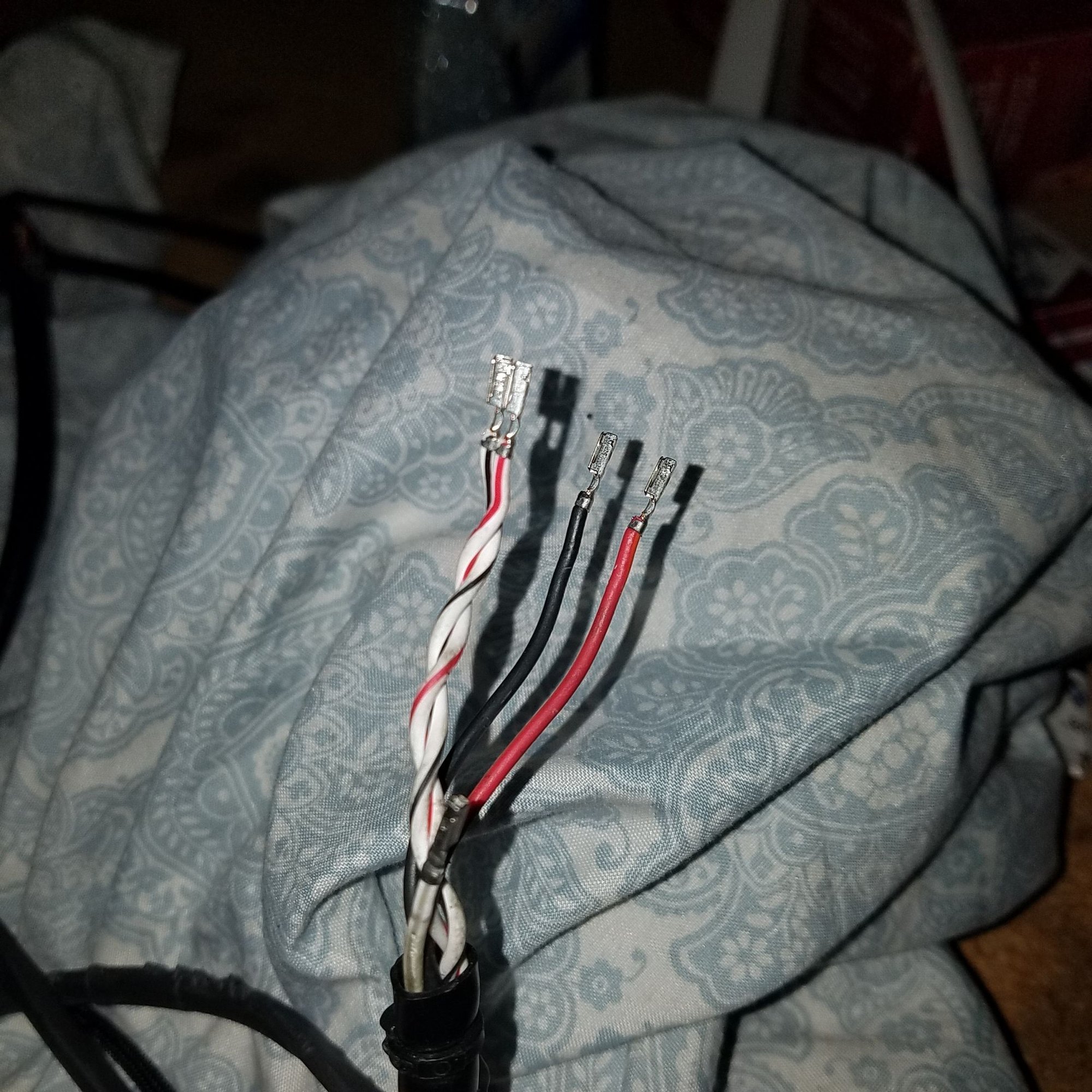

Hand control wires after the connector was removed. A site called Lawabidingbiker.com has a really good video up on youtube showing how to remove the pins from the connector. It's really very easy.
You can see here that the heat shrink got skinned up every step of the way during the pull. You can also see the corner i was talking about that is razor sharp on the inside.
Here is the finished product all ready to be mounted. Unfortantly, four straight hours of working in 109° heat took its toll and mounting will have to wait until tomorrow. Only on AZ is it 109° at 2 AM.
