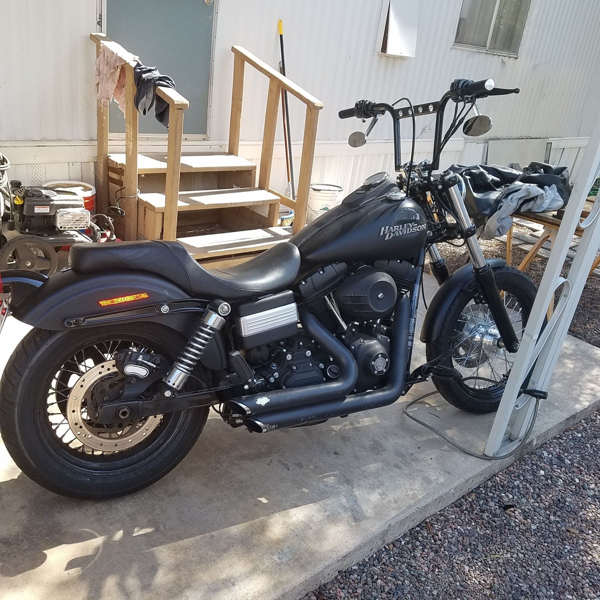

Thanks for the compliments fella's.
Yes sir, been rehydrating all day.

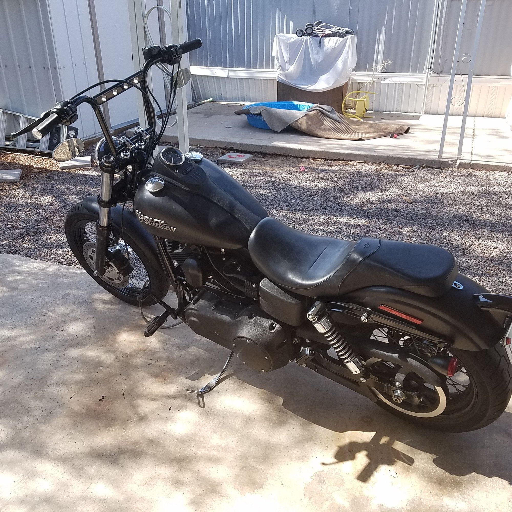

I got my 10$ swap meet mirrors on. I know now why they were only 10$. The first few threads on the left mirror were stripped out. I had to remove the two flat washers to get the threads in deep enough to grab. Still got a lock washer so it should hold.
Going for my first real ride tonight. Just got to position my headlight so I am not blinding others on the road. Then do a fluid and tire pressure check and I'm off.
Wide glide is what, only and an inch wider than mid glide? That one inch makes a huge difference.
Next up is exchanging tanks. I am not sure how a yellow with black flamed tank is going to look but i will be finding out soon.
My bikes good side!
