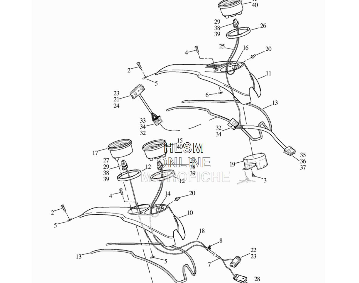

As for your 07, you are precanbus. I have the same dilemma has you do though, we have two plugs coming from the brain area of the bike. I would assume they are interchangeable, but I dont know. I cant tell for sure, that each plug carries the data needed to run a tach/speedo combo gauge, or if its truly setup for one gauge speedo, one gauge tach.

Here is the diagram from the service manual, but even after reading my service manual, it made no distinction for the FXDL... just that they are both 12 pin connections
