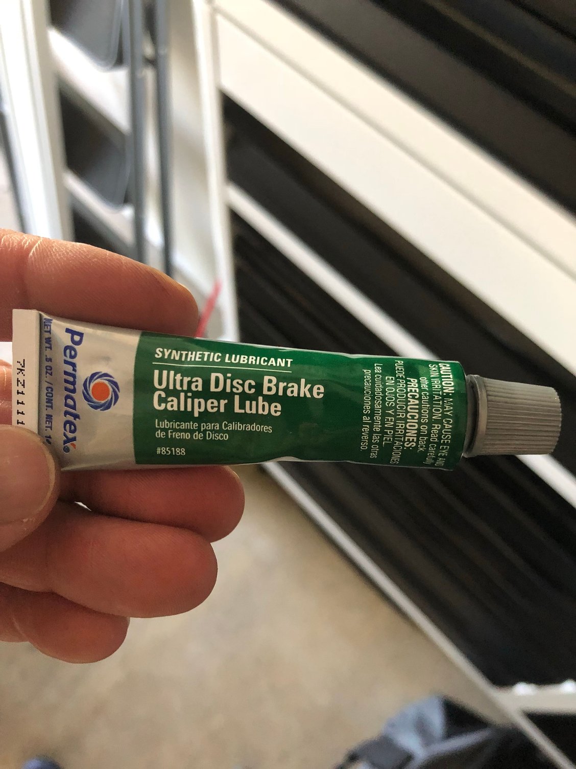

Caliper grease
So based off the videos I found, I disassembled the front brake lever and cleaned it, then applied some lubricant to the plunger.
Once you take the lever off there is quite a bit of sandy dried dirt inside that area as its not sealed up at all, and my bike only has 2600 miles. As the lever has improved it still sticks a bit. Is it possible I squeeze it too hard and the plunger piston in the master cylinder is damaged now, or will it improve once it's heated on my next ride and sort itself out you think?
Here's a pic of what I used as "rubber grease" mentioned in the video I saw, metal/rubber area. I figured brake grease was best considering the options.
