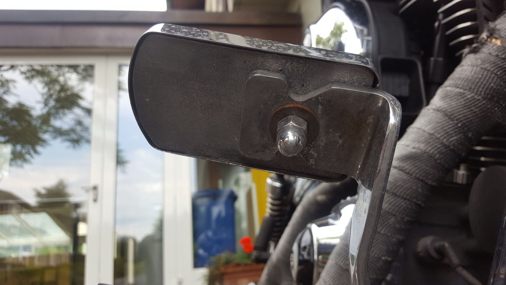

So I have an '07 Street Bob and I have extended forward controls on it. I recently put an arlen ness AC on it and it pushes my leg out to the point where I have to pigeon toe in order to brake and I am not comfortable doing that. So I found a brake pedal from a Roadglide local for $10 and before I buy it I wanted to see if it would fit on my setup? I figured this would be the cheapest option vs a new extended pedal or a new air cleaner...

I put a touring pedal on my bike. Had to make an aluminum backing piece for it as the stock lever isn't wide enough to stop the pedal part from tilting when you put your foot on it.
Works great and no pigeon toeing

Awesome, thanks for the pics that helps!
