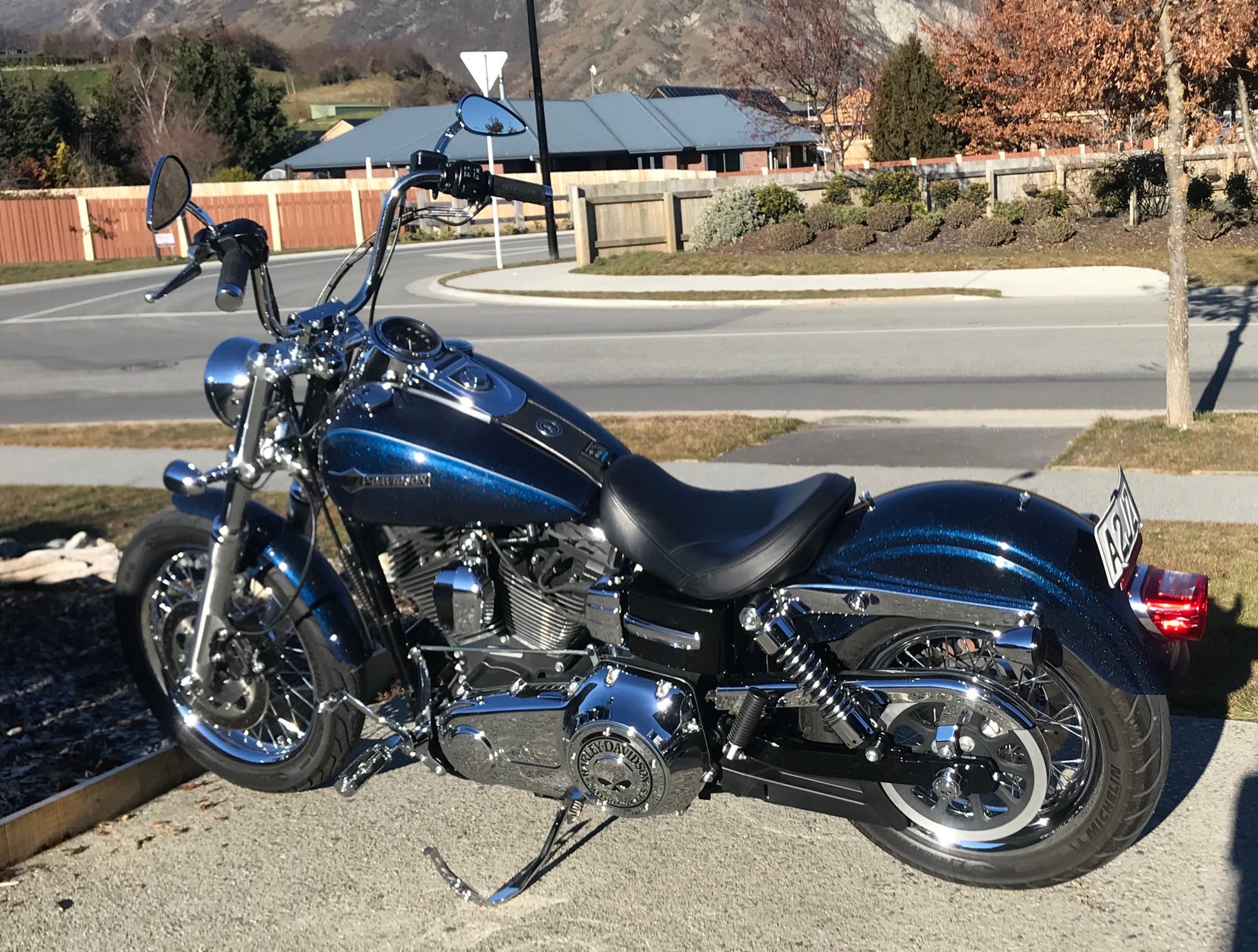

HI guys, Considering putting a Dunlop GT502 180/60/17 on my 2012 FXDC. Stock tire is a 160/70/17. The only issues that I am finding is to make sure that your signal light wiring is well secured. Anyone done the conversion on this bike?

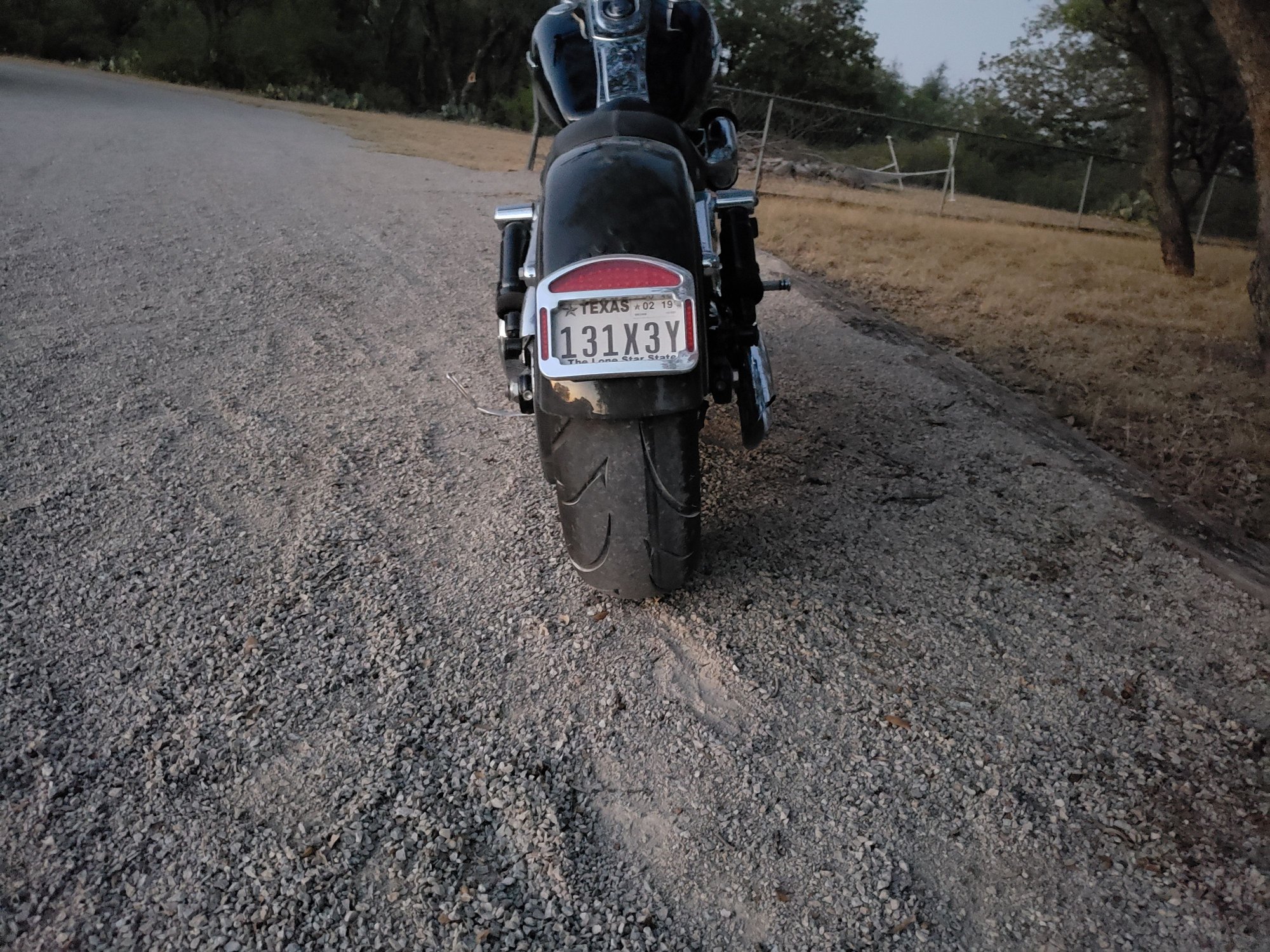

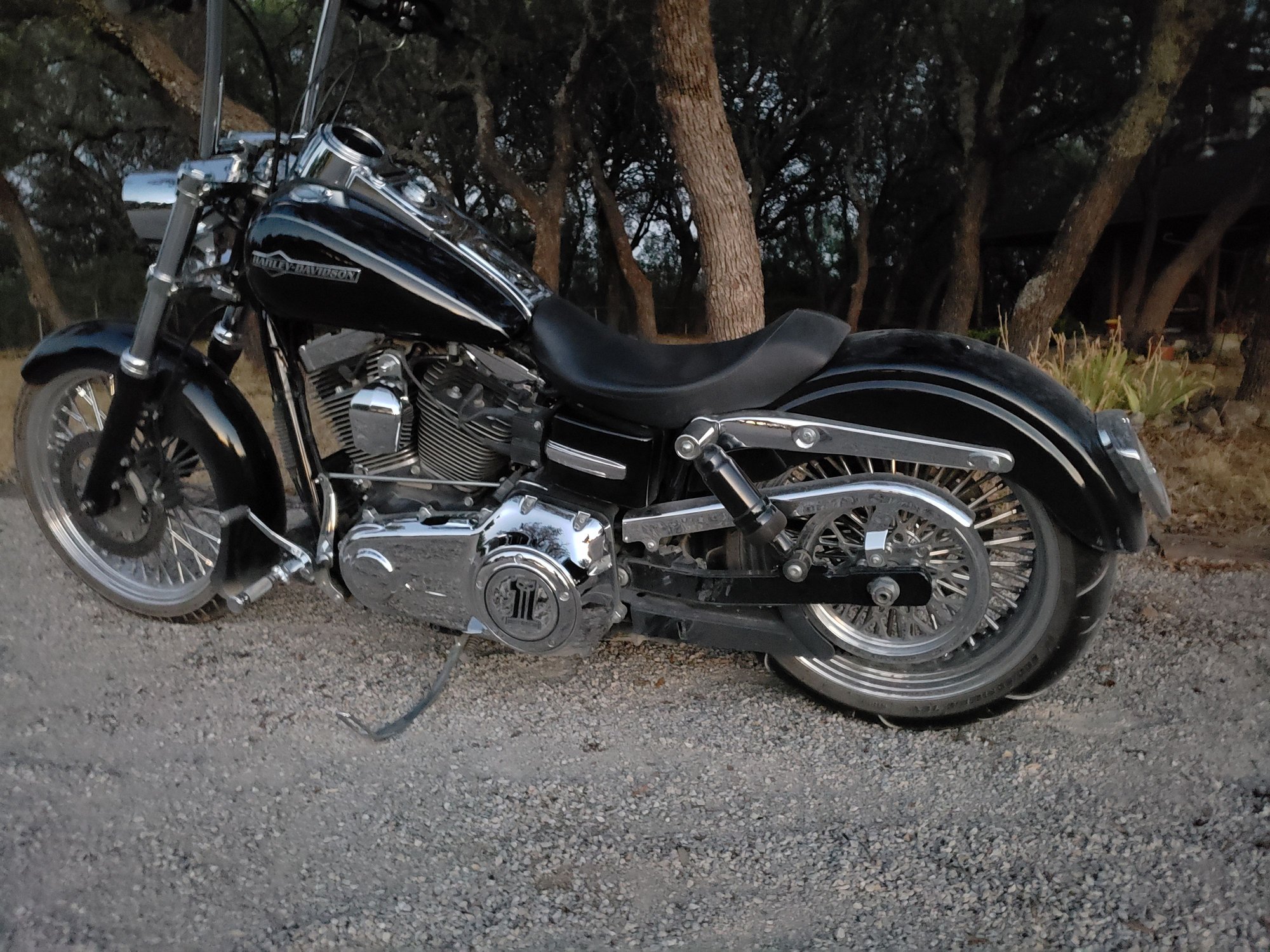

I put a 18x5.5 wheel and 200 tire on the back of my 2012 FXDC. No clearance issues whatsoever, even with the air ride all the way down. Ignore the "rub mark" in the picture. I ran over something wet lol.
