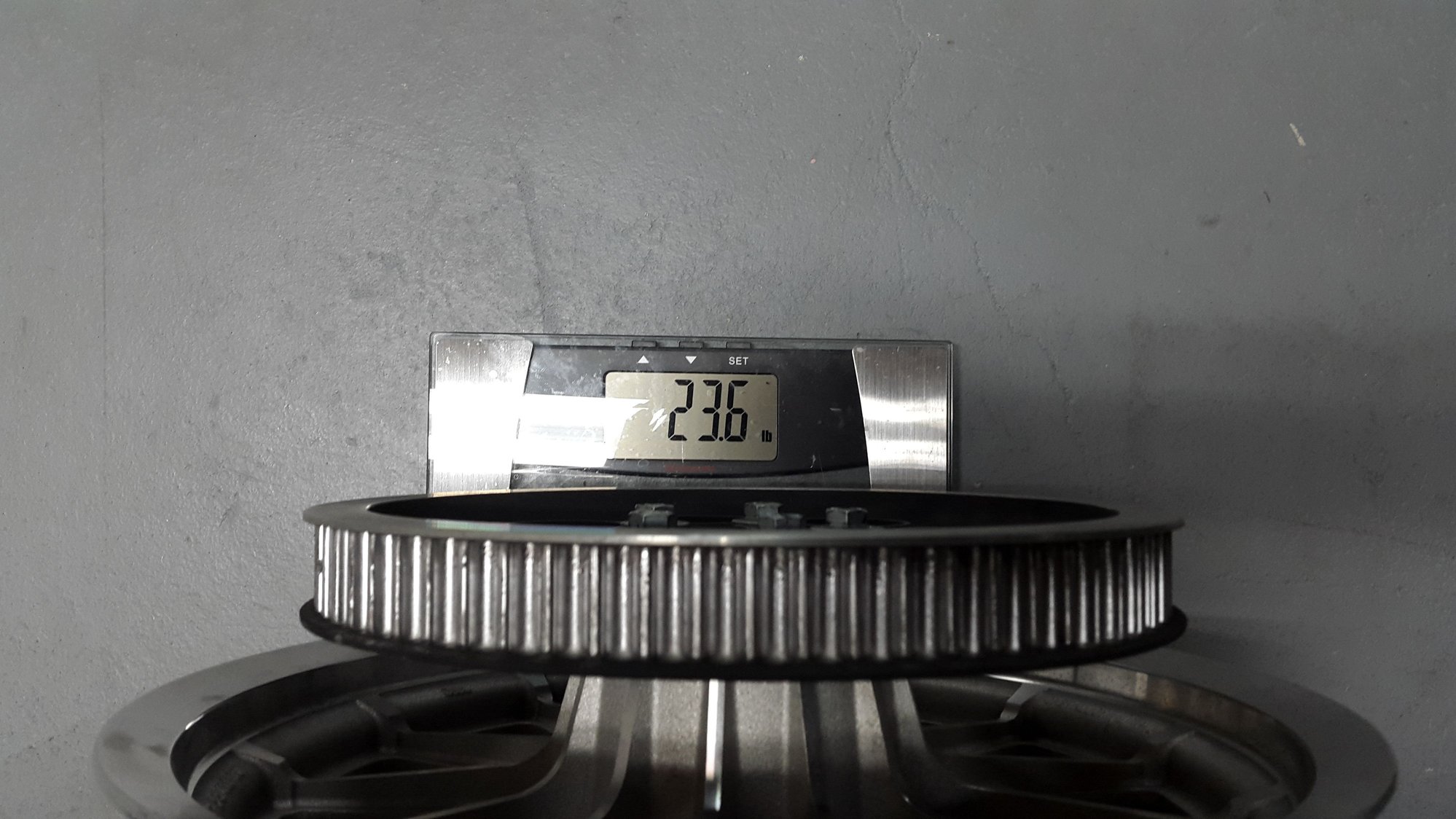

Here you go. The front is complete with both rotors, the rear is missing the brake rotor. According to HD, the weight of the stock rear rotor is 5.67 pounds, but that could be "shipping weight".

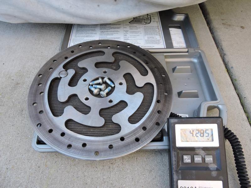

I think Mike covered pretty much everything here...
The '08 style (heavier center carrier, smaller scallop cuts.) floating front rotors are 5.4 lbs each.
EDIT/UPDATE: 4/23/16 ................ (edit/updates: post#2 2/28/16, #9 3/11/16, #14 4/23/16)
The weight of a 16x3 9-spoke "Mag" wheel was brought up in this specific post HERE within this thread HERE.
So I decided to gather up some 2000-2007/08 16x3 and 2009-later 17", 18" and 19" "Touring" wheel weights (Excludes 17" Airstrike at this point)
It's not "perfect"...there will be a slight variance from posted weights because I didn't remove the wheel balance weights and the 16" "Airstrike" has 25mm bearings as opposed to 1" bearings in the other 16" wheels
Wheels - Lightest to Heaviest (weights shown below include rotors/bolts)
16x3 Laced Spoke - "Profile" ..... = 23.115 lbs (Includes tube)
17x3 "Impeller" ....................... = 23.37 lbs (38.725 - 15.335)
16x3 9-Spoke ........................ = 23.685 lbs
19x3.5 "Enforcer".................... = 24.645 lbs
17x3 28-Spoke "Knuckles"......... = 24.905 lbs
16x3 Laced Spoke - Drop Center = 24.97 lbs (Includes tube)
18x3.5 "Airstrike"..................... = 26.125 lbs
16x3 "Airstrike" ...................... = 26.36 lbs
Wheels/Tire Assys - Lightest to Heaviest (weights shown below include wheel/tire/rotors/bolts)
19x3.5 "Enforcer" ........................... 24.645 + 13 = 37.645 lbs
(Don't have tire presently...acquired weight from Dunlop Customer Service)
17x3 "Impeller" ................................................ = 38.725 lbs
16x3 Laced Spoke - "Profile" ....... 23.115 + 16.515 = 39.63 lbs
16x3 9-Spoke .......................... 23.685 + 16.515 = 40.20 lbs
17x3 28-Spoke "Knuckles" .......... 24.905 + 15.355 = 40.26 lbs
18x3.5 "Airstrike" ...................... 26.125 + 14.210 = 40.335 lbs
16x3 Laced Spoke - Drop Center ... 24.97 + 16.515 = 41.485 lbs
16x3 "Airstrike" .......................... 26.36 + 16.515 = 42.875 lbs
16x3 Laced Spoke - "Profile" 12.755 + (2 x 4.310 rotors/bolts) + 1.740 Tube = 23.115 lbs
16x3 Laced Spoke - Drop Center 14.610 + (2 x 4.310 rotor/bolts)
+ 1.740 Tube = 24.97 lbs
16x3 9-Spoke = 23.685 lbs
16x3 "Airstrike" 17.740 + (2 x 4.310
rotors/bolts) = 26.36 lbs
17x3 28-Spoke "Knuckles" 16.335 + (2 x 4.285 rotor/bolts) = 24.905 lbs
17x3 "Impeller" =
23.37 lbs (38.725 - 15.335 Tire)
18x3.5 "Airstrike"
= 26.125 lbs
19x3.5 "Enforcer"
= 24.645 lbs
Dunlop 402F MT90B16 = 16.515 lbs
Dunlop 408F 130/80B17 = 15.355 lbs
Dunlop 408F 130/70B18 = 14.210 lbs
Dunlop 408F 130/60B19 = 13 lbs
(Don't have one presently...acquired photo from ebay and weight from Dunlop Customer Service)
Because I didn't have one other thing better to do

The 13 Spoke cast wheels the OP wants to know about are not included in that compilation; that's what my photos are. The weight of that rear rotor might be a number I'd use (4.310) in lieu of the 5.97 pounds HD listed.
