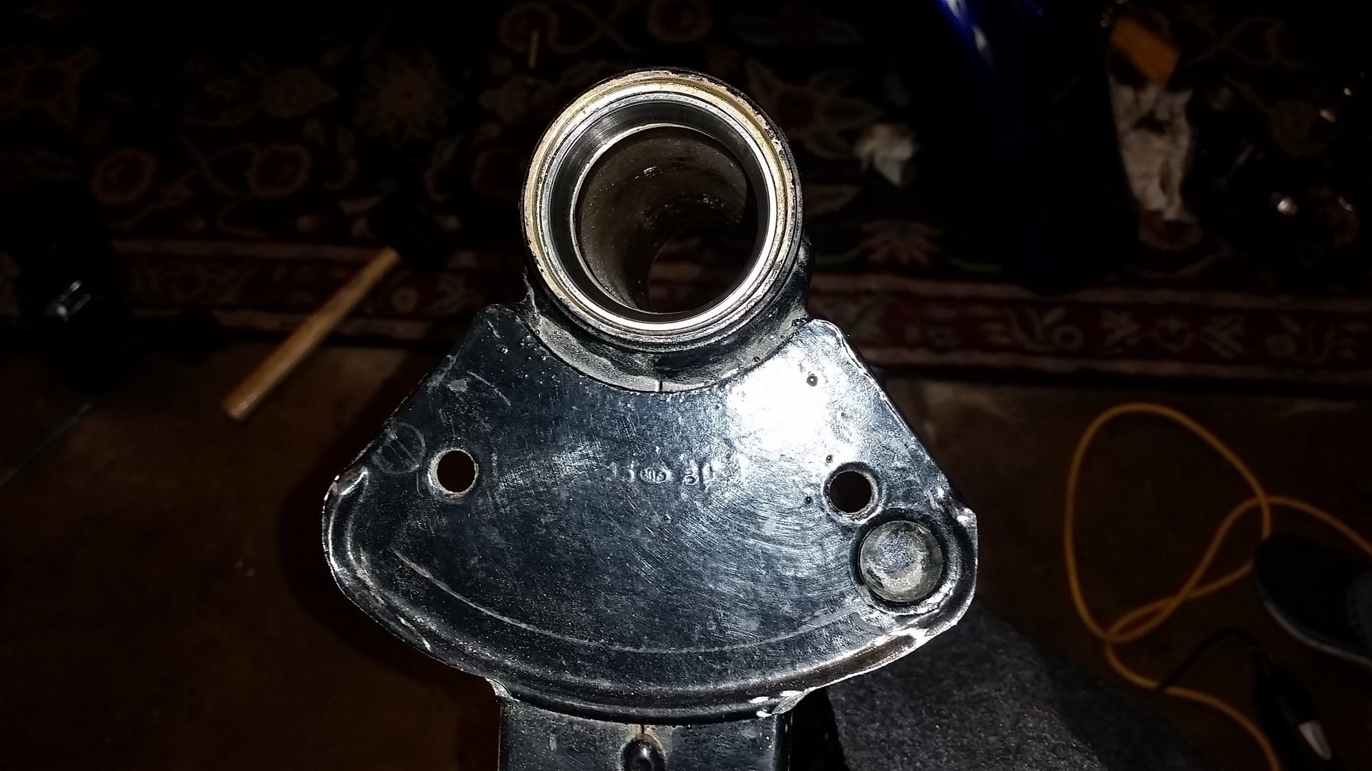

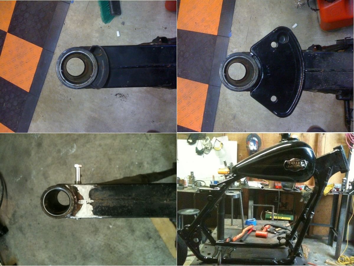

At this point, we're ready to mock up the new triples. The frame mods happen to the locking plate behind the neck. It needs to be clearanced to allow the triple

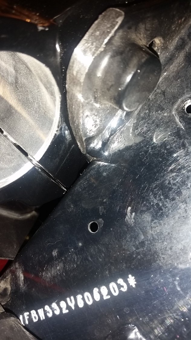

At this point, I've hit the first snag. These have been installed by Howard on newer frame bikes. The newer bikes all have the fork stop pads as part of the locking plate. The older bikes use a rubber donut around the fork that hits the frame and acts as a stop. Obviously these won't fit on the wider fork tube, and cutting them up to work would be a tedious task. Instead, my neighbor will be assisting by making some sleeves to install on the existing fork stop pins to increase their diameter, making up for the lack of a pad. Once these are done, I'll be sharing their specs with Howard to experiment with and perhaps they'll be the permanent solution for the older frame bikes.

I'm having difficulty figuring out where you were grinding.
Looks like he took off the outer and lower edges of the fork lock plate. I assume that was necessary because of the larger diameter of the fork tubes.

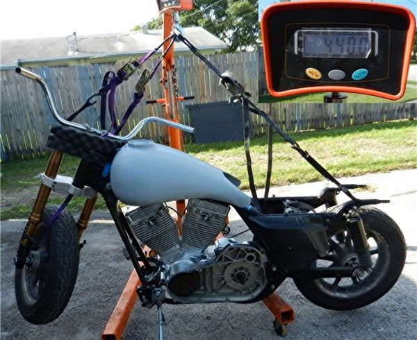

Wow! A guy that can think in the abstract! Good thinking. The 2014's~current have a smaller locking plate due to the 49mm fork tubes. They would not fit using the older (41mm) locking plate. Just the sides. I am using a 2011 locking plate with the new fork stop and my model I was using (bought a 2000 Road King) but previously cut the thing off and through it away. I can be a moron sometimes. I will remove this fork and install my standard type 49mm fork & trees in this one. My plans are a super light (as possible) bagger using composite material where I can. So far this is a new crate 124 S&S w/ Spike 6 speed w/6.5 final, 7 gal. tank & my C/F wheels (not installed). I will run radial tires for the weight reduction. I need to purchase EFI but have a 2006 computer to run it. TJ316 is making a gorgeous bike for Daytona, but I wish to give him a little something to think about.
PS: the shocks on only on it so I do not scratch up my new #6's.

At this point, we're ready to mock up the new triples. The frame mods happen to the locking plate behind the neck. It needs to be clearanced to allow the triple to move full swing.
