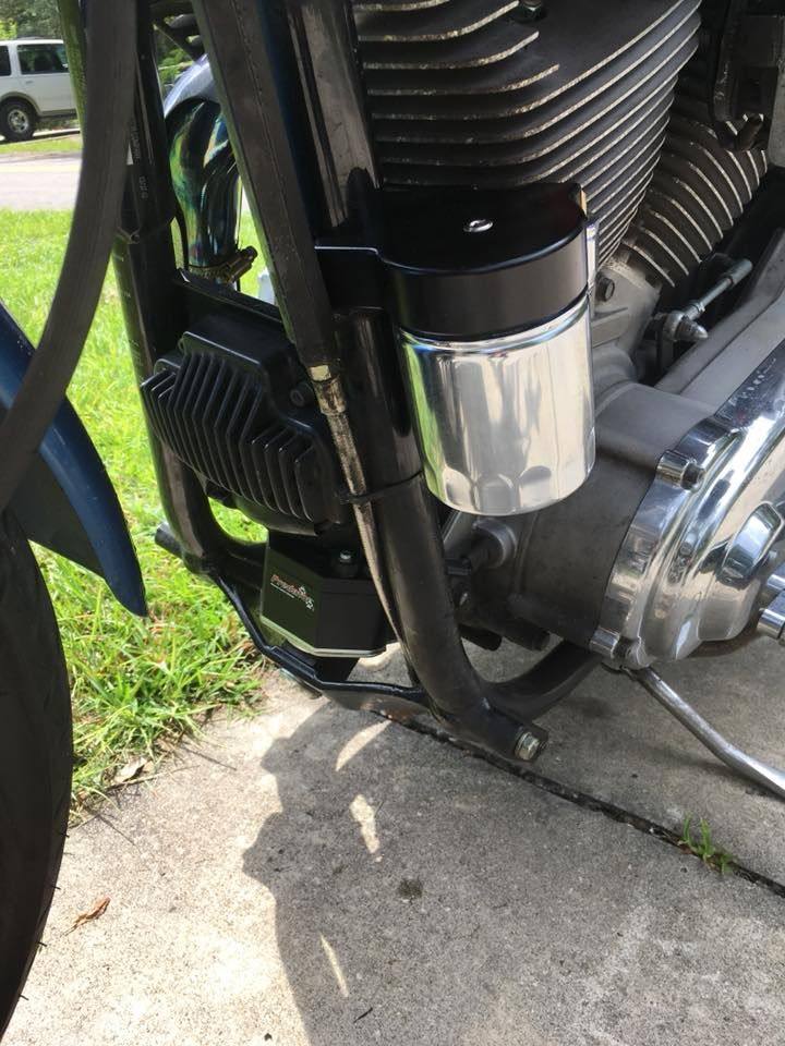

I Consider Going to a Predator Mount one of my better Mods, and was a good time time to Relocate the Filter as well to keep Oil off the new mount, Voltage Regulator, and Stator Wiring as well ..
