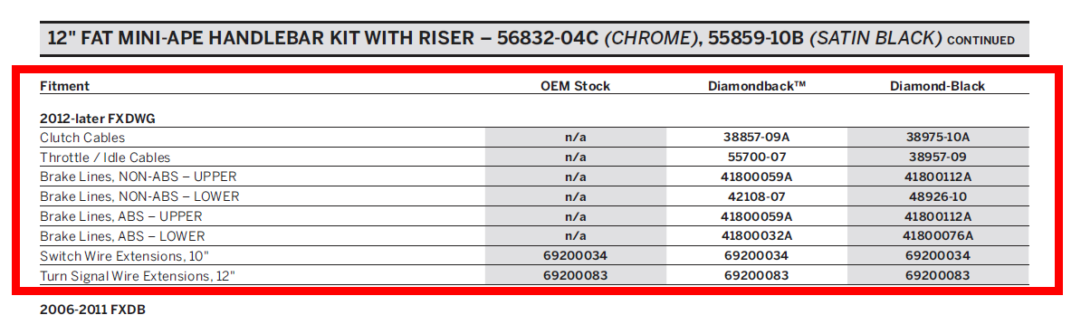

trying to install Apes, on my 2015 Dyna Wide Glide
found several kits that I can get throttle cables and clutch cable along with wire extensions
here's what I need help with
I cannot find anyone with a longer abs line for the front brake, burly, jp, Barnett, do not have it
it comes off the master cylinder, harlined into a box that connects to the abs lines then hard lined out to the caliper
really wanting to put these bars on any pointing in the right direction would be huge
thanks in advance

I installed the HD 12" mini-apes on my 2015 FXDWG. if those are your bars, the kit details are below
