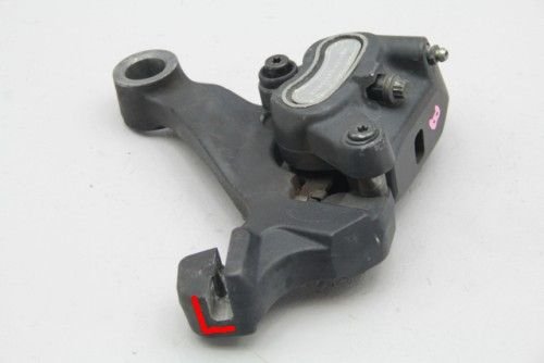

probably closer to 3/16th which doesnt sound like much at all but makes a lot of difference. now that you bring up the pulley spacer i have a .20 spacer for that belt...otherwise it hits the tire. but...how the hell do you center the pulley now because you lose your centering ring
and both the pulley holes and the spacer holes are bigger than the bolts.
as long as i machine the outside of the caliper bracket and then maybe grind some on the tab for it....increase the left side spacer i should be ok... aside from getting the pulley to run true..
thanks for all your comments btw
I had the same task with a 17" x 6" rim....build a .250" spacer with centering bosses and sleeve the pulley to .440" to fit the longer shank ARP bolts that are .437" I also machined the caliper slot and tab but did not have to shorten swing arm tab

looks nice...so you machined the caliper slot deeper? can you elaborate on that? i was afraid of going deeper, didnt want to weaken it.

I only increased depth by .100 " which still left approx. .400 " plenty of strength for caliper

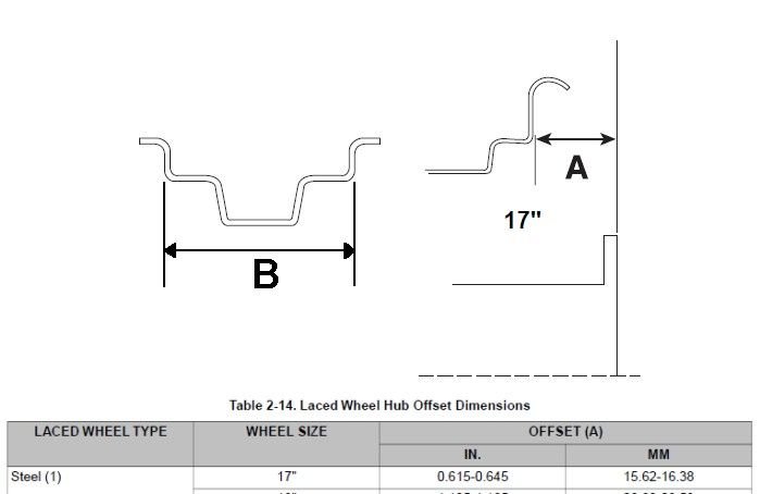

Originally Posted by sickistrick
my other thought is that the wheel was never centered to begin with and was just less noticeable with the narrower tire.
as far as figuring out an offset dimension for that wheel im not sure how u would go about that other than centering it because no wide glide hub ( dyna) used a 6in wide wheel.
In your case, you would figure it by taking 1/2 of the difference of "B" between the two rims and Add it to "A" ("A" = Published WG Spec of .615 - .645" )
If you had thought to check your original "Centering", you would add or subtract the amount needed from the calculated value above to achieve"Nirvana"
It may help you "get your head around" the question/decision of possibly making the caliper weaker with some machining by "Thinking About" that IF your bike only had to move forward AND the caliper was initially positioned correctly before clamping down the axle ... what exactly is the slot and lower half of the bracket doing for you?
Now, I'm Not in any way suggesting you remove all that Area, just discussing Concepts
No, Not really possible ... (Unless you were really committed )
The slot not doing much but the lower tab, with creates the slot is for when the bike rolls backwards. Also most every time I'm on a hill I use my front brake

Yeah, that's why I said ... "...IF your bike only had to move forward ..."
I would imagine that it is Not asking much of that "Area" when used in the other direction even with Slide-Hammering the Brakes
That's what I'm saying "The slot not doing much but the lower tab, with creates the slot is for when the bike rolls backwards. Also most every time I'm on a hill I use my front brake "
