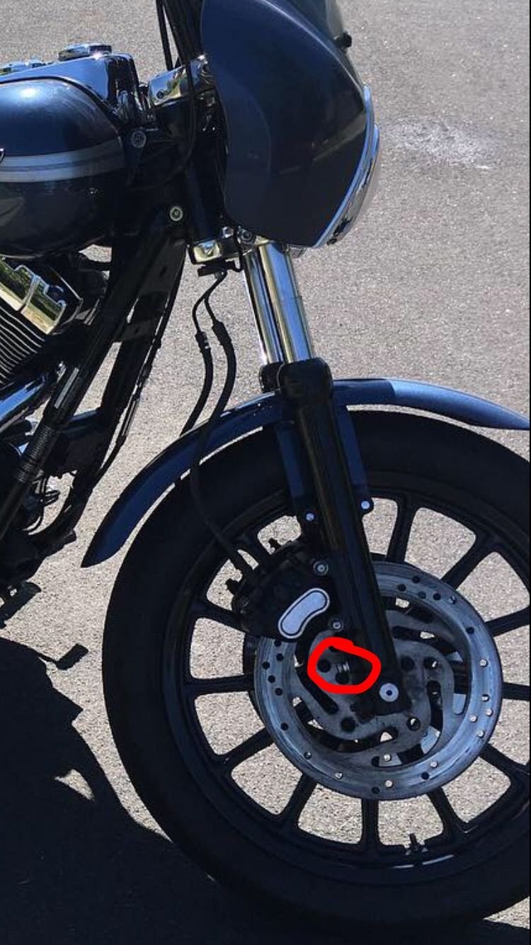

Default Front fork oil bleeder
Was going to change oil in my forks... honestly can’t find and great or consistent info on the fxdxt and the manual is vague. Anyways some of the ways I’ve seen are beyond my skills, although I do have a screw near the bottom of the forks. If not I’ll have a shop do it when I get a tire change. What you think??
