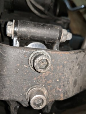

More then likely it’s your front mount not the rear, plus if they just threw that mount in there without doing the full power train alignment, they did you a dis-service. If the front is original it is way past do to be changed. They are crappy when new and only get worse...do you know which brand they put in the back.?
Them telling you it’s the flywheel just feels wrong to me. Chances are it’s well within spec, but if your curious you could always check the runout....just to be sure, but the evo is pretty bulletproof . I had a 98 myself, new in 98, a Superglide though. Had a slight vibration as well around 2800 rpm. Ran like a rapped ape after I tweaked it.....
also this....in case this shows up....
