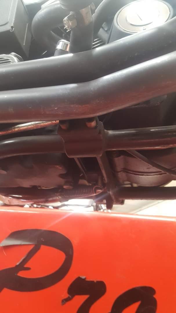

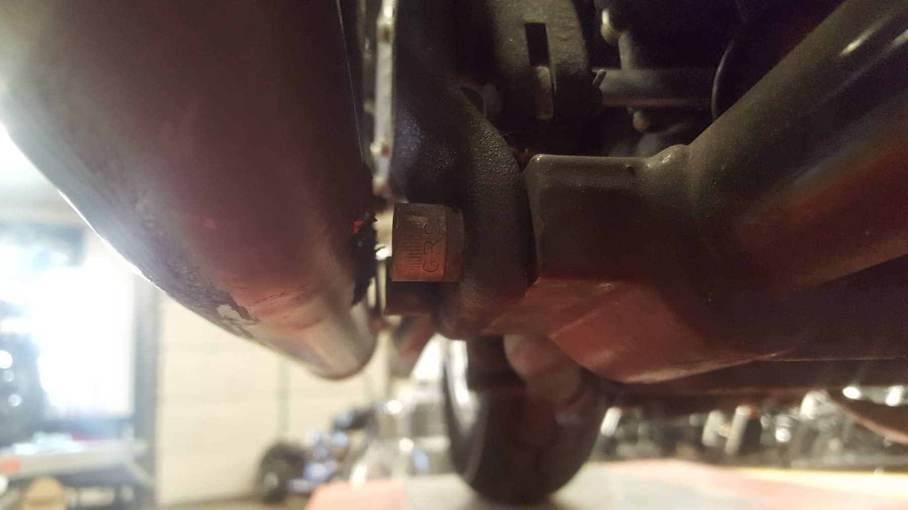

So a friend of mine was able to find an interesting issue. Basically the right footpegs mounts we're hitting my thunderheader. I haven't been able to test drive it yet but it seems like this would cause some serious vibrstion:
Old Oct 27, 2018 | 09:50 PM
crusader1xxx's Avatar
crusader1xxx
Posts: 1,246
Likes: 251
From: Belle River Ontario
Yes it would as the exhaust moves with the motor and the foot pegs stay stationary with the frame. Can’t tell from the pictures but if it’s the bolts, get some ARP ones or button head ones ...that should give enough clearance.
