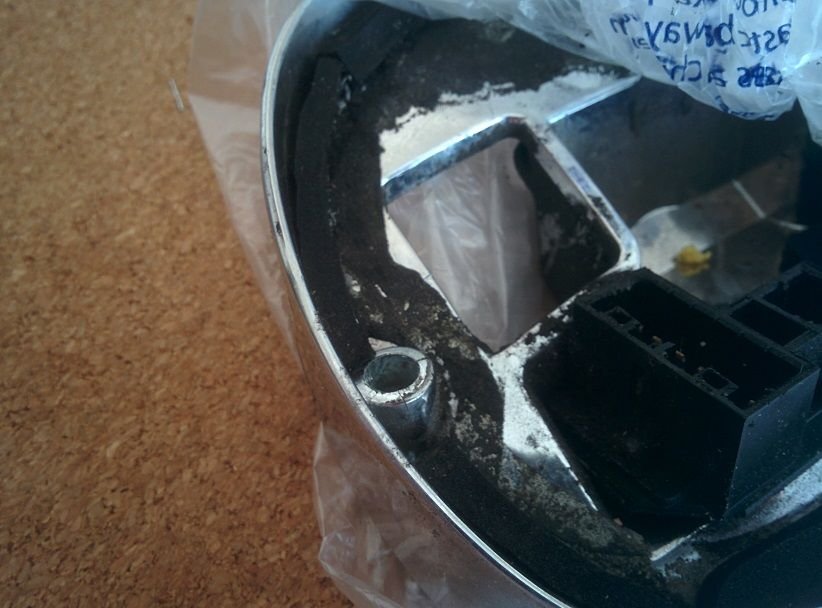

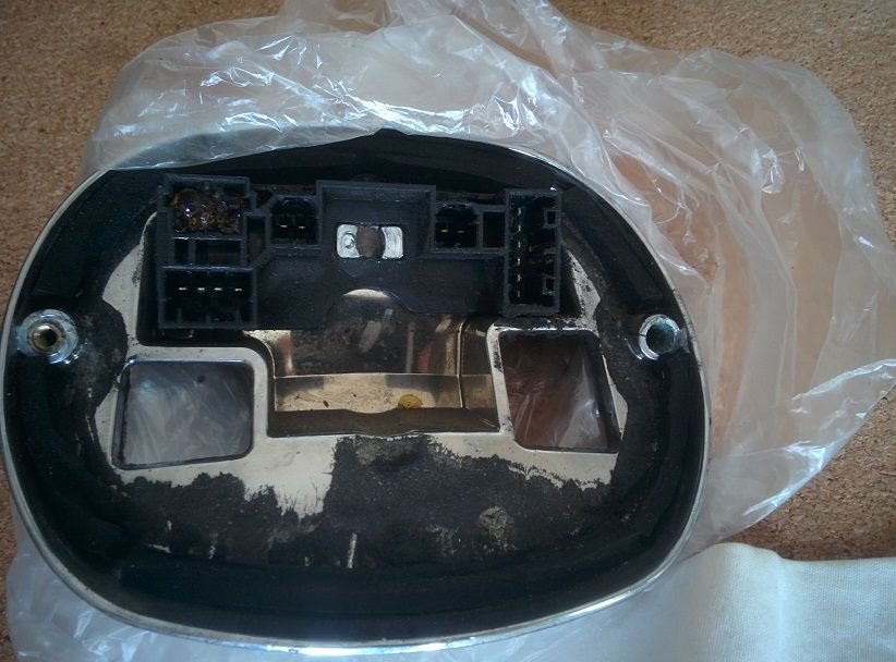

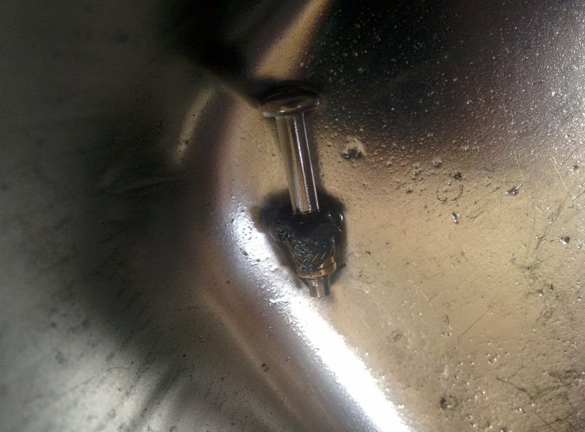

2007 FXDB. Looking up pictures of "well nut" does indeed bear an extremely strong resemblance. Mine also have a bit of outside threading ostensibly to provide additional grab. Finally, some pictures:
Overall 'receptacle' unit, with some aftermarket rubber around the edges
Lazy, fallin' down on the job thingy
Working thingy
What remains after I attempted to epoxy it together

You mean the cheap plastic base the l lens screws to? I have used two part epoxy to repair a couple of those , gluing the brass thread insert with limited success. Use blue lock tight on the screws and be very careful not to over tighten. Push the lens in until the gasket compresses then run the screw up to the lens edge and maybe 1/4 turn more.

Not well nuts. Those look molded in place. Hard to repair.
Is the housing metal or plastic?
If metal, regular JB Weld should do a pretty good job.
If plastic, you should use a structural adhesive designed for metal/plastic assemblies. JB Weld makes one that has worked well for me, but it's NOT the same as regular JB.
Either way, you have to be careful with cleaning both surfaces and eliminating air pockets when the insert is re-inserted. The old adhesive should be scraped off and both parts need adequate "tooth" for the adhesive to grab onto. Also clamp it and leave it undisturbed for at least 24 hours.
A thread insert may also be a possibility. Keensert, time-sert, helicoil, etc

Yeah, 85% sure we're talking about the same thing. I tried blue loctite at first but that instantly failed me. Epoxy lasted almost 10 seconds before it popped off, resulting in that 4th pic you see

Feeling pretty darned plastic to me. The inserts do look brass, though mine is now encased in epoxy. Had a feeling there was a cross-material special epoxy. Will look for it
Thread insert is interesting, it seems like the plastic might give out though
