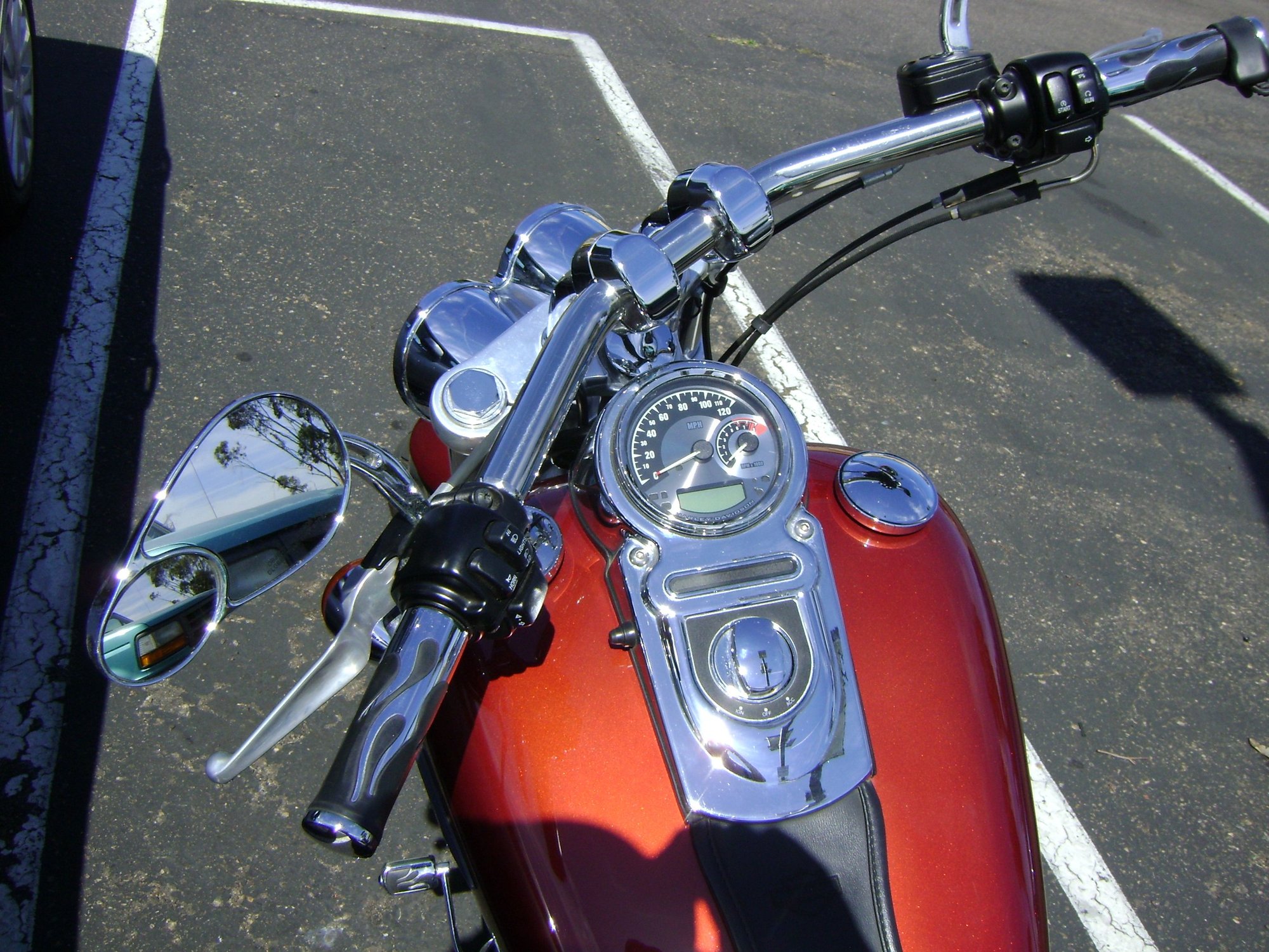

The purpose of pullbacks and tilted forward bars is mostly for looks I run mine this way. Most running pullbacks do so to have their gauge mount tilt towards them. Bar/riser height is all for preference when I had fixed tbars at 14” my left shoulder would experience discomfort going down to 11.5 cured this issue. Pictured here is my personal setup
