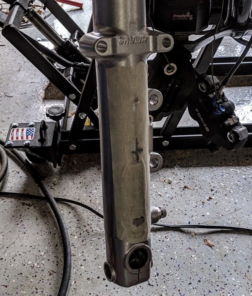

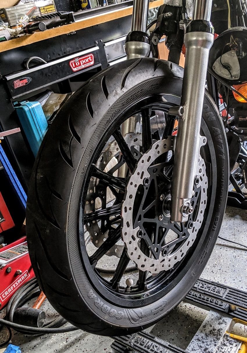

Okay, progress... I pondered this for a few days before doing anything, putting the wheel on and off, old rotors, new rotors, measuring things... I definitely didn't want to start cutting into my sliders if I wasn't sure it was gonna work. on close examination, everything was close... The bobbins were definitely touching the fork legs, and so were the rotor bolts, slightly (the original button heads, not the taller ARPs). This morning I woke up determined not to be sidelined by this issue anymore. I was going to mock it up once more and make a final determination as to how close (or far) from fitting everything was. If it was really close, I would clearance the sliders... If it looked like too big a problem, I was gonna abandon the BrakeTech 330mm (13") rotors in favor of their 320mm (12.6") rotors. The 330s are 6mm thick, the 320s are only 5mm. I can't exchange them, but figured I could try selling them. I wrapped each slider with tape to see exactly where the interference was. The lower marks are the rotor bolts, in the middle are the rotor bobbins, and up top the small mark MAY have happened taking the wheel out, but it could have actually been the top of the rotor. It was honestly really tight all around.
On final examination, I decided I could clearance the sliders. First I mocked up one of the new Speed Merchant 13" brackets (replacing my original 11.5" radial mounts), just to be sure there wasn't another unexpected issue before cutting into things. They seemed to fit fine, and the caliper looked like it was in the right place.

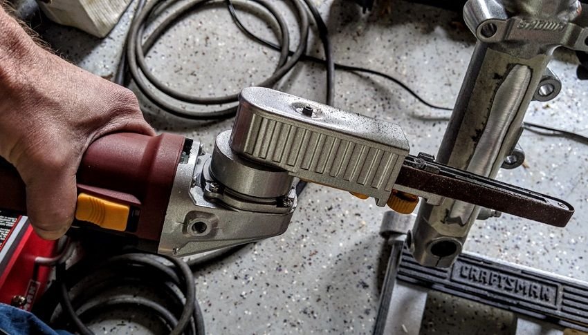

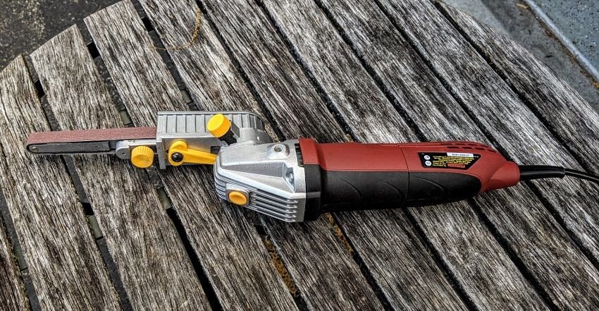

In a perfect world, setting up the sliders on a milling machine would probably be the best way to proceed, but I don't have a milling machine (sometimes I really miss the days that I had access to an old Bridgeport). Using my angle grinder seemed prone to error, so I ran out and got this handheld belt sander. $38 at Harbor Freight. While I totally understand the anti-cheap-chinese sentiment, there is a place for it... And this was it!
The sander worked well... Very controllable, and I was able to keep the fork legs on the bike without any problem.

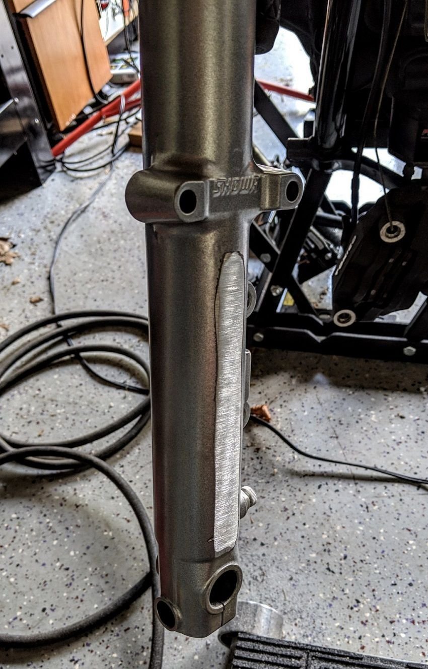

I basically brought the original clearance section (around the rotor bolts) all the way up to the top of the rotor on each slider. Actually a little bit deeper, as I took a touch off the factory-clearanced area for the bolts too. Success... The wheel now spins freely! On Tuesday (my day off), I may take a touch more off through the whole section, as it's still kind of tight. But I'm now confident this will work! Thank you everybody for chiming in!!!!
Absolutely! Can't be beat for those things you would figure out how to do with out if they were more expensive, and probably won't use more than once or twice. (Apparently, cggorman found this not to be the case...)
