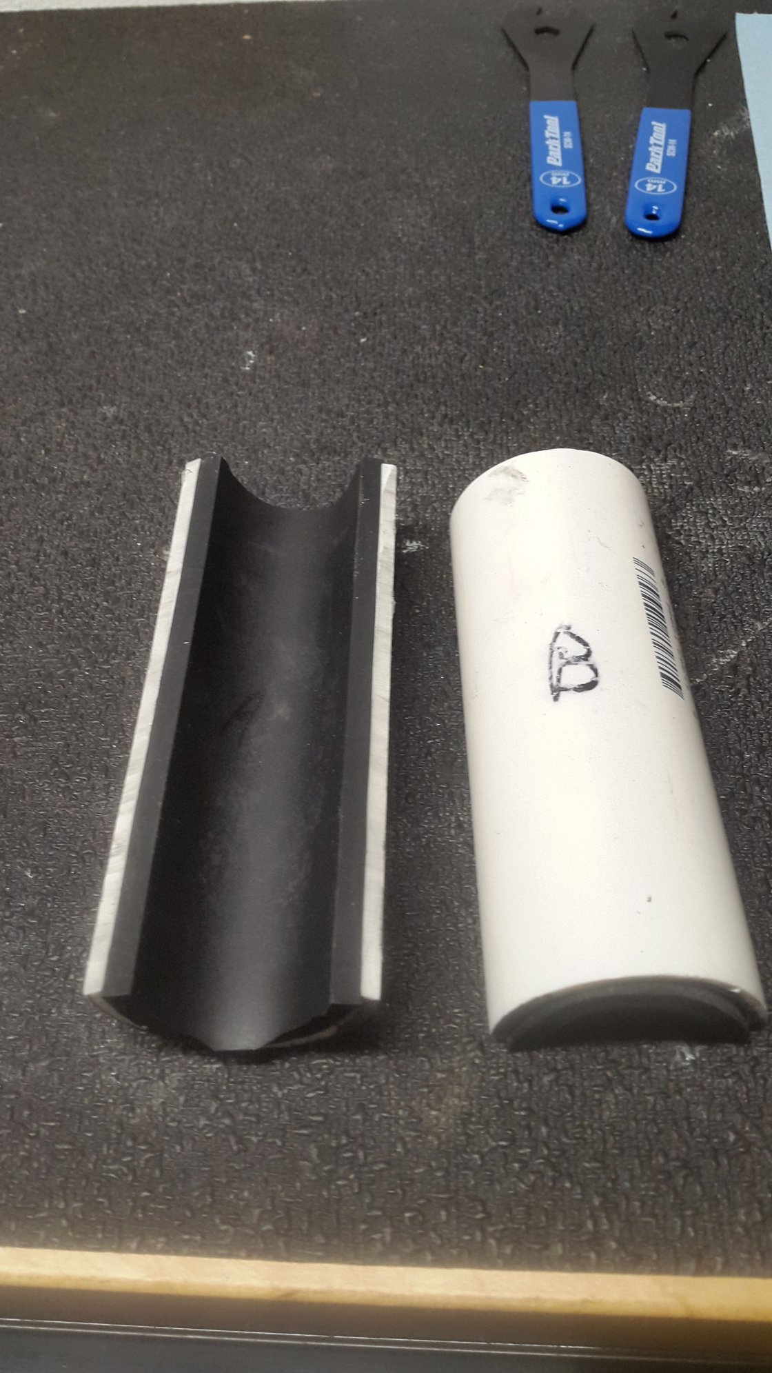

A little late on the clamp, I like the wood clamp idea but I'd screw the clamp together clamping say a piece of 1/4 inch thick wood. Use a 1 1/2 forstner bit to drill a hole at the gap.. Fork tubes are 38mm which is real close to 1 1/2 inches. I use a about a 2 x 2 3/4 x 1 rectangular aluminum block (scrap) with one ends bored to 38mm and slotted so that when I clamp the block in the vice, it grabs the tube.

Thanks for the info on your clamp and my PC question. Yes, your thoughts on using a Forstner bit to "perfect fit" the clamp make a lot of sense. I thought I could keep it slightly "universal" and even hold one of lowers in it if needed...

Thanks for your info, Howard. If I do this again, a more robust tool will happen! For this go-round, I think my clunky wood setup will work. I have plenty of clearance from the bench, and it feels very secure.

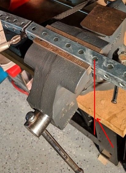

Tarik, I think the reference (or at least mine is ) was to the clearance of the Vertical_Drop from the Back Jaw to Bench Top ... as a General Shop Practice.
Do you have clearance?

Having a way to hold the fork tube in a vise makes a lot of things easier, not the least of which is putting the fork cap back on under spring pressure (ie you aren't holding the fork and the cap at the same time while trying to keep the male tube from going down into the slider). It also provides a nice vertical hold for measuring fork oil level exactly which is a better practice than adding a liquid measurement volume. I do enough forks that it's worth the little bit of time I took making the "tools", not to mention it makes it a less frustrating experience.
