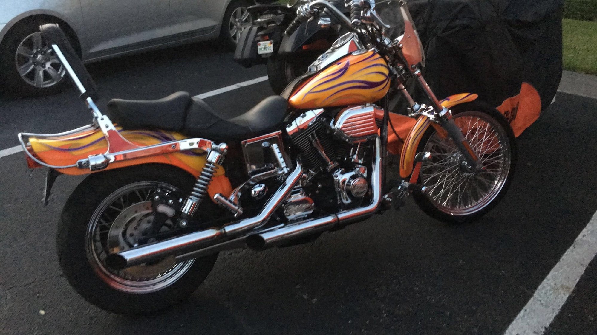

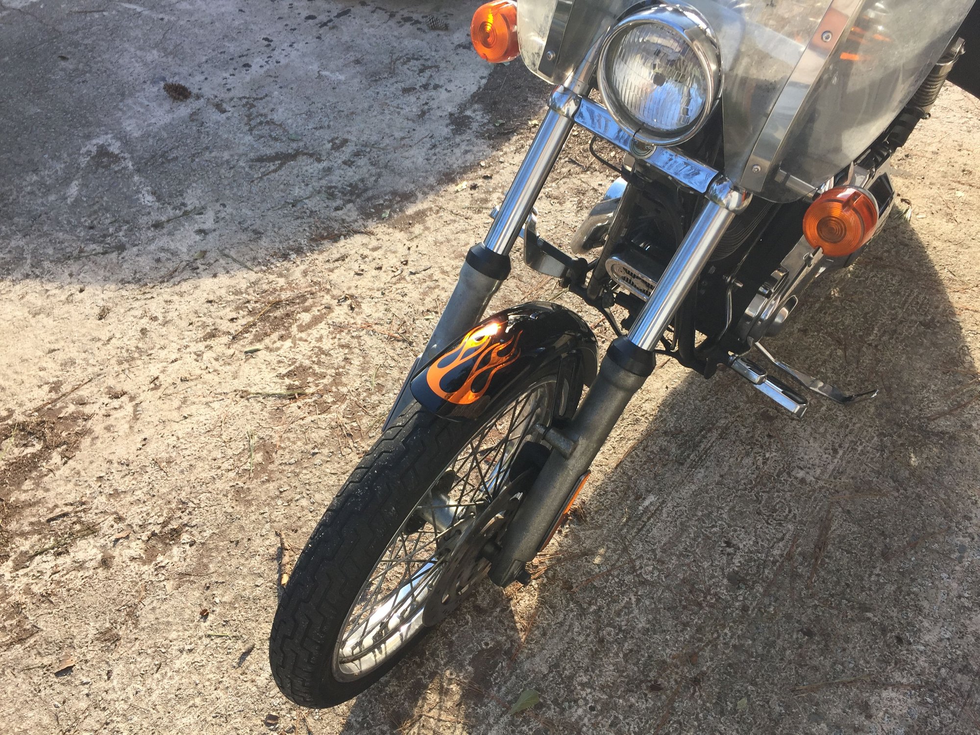

Hey guys, I’m new to this forum. The username is Texasstreetglide01, but I decided to sell my street glide & keep my dyna wide glide. Long story short, I bought this bike in vero beach from a small car lot that took it in on a trade. I was in love and excited being my first Harley. Growing up, my dad had a FXDWG and I loved the looks of it. Anyways, it was ugly as hell, cut out, idled rough, and was considered an eye sore to most people, but to me it was perfect! I’ll post a picture of the day I bought it, and a picture of it now. I’ve done 99% of the work myself except the paint job. Please share your experiences and pointers as to what to change next. A few things I’m debating is a solid rear wheel off of a fat boy, progressive 11” shocks, and trying to find a rear tail light option to replace the big stock one.
This was the day I rode it home from vero beach to Melbourne Florida
This is where I’m at with it currently. Still wanting to drop the back a little but not sure which shocks to go with. I want the 11” progressive enclosed shocks instead of exposed springs. Thoughts?

I like what you have done so far. Looks great. Will be interesting to see with solid rims. I like the spokes but post a picture if you go with the solid’s.

Looks real good, I like the solid rear wheel look as well.

Looks good. Except the rear exhaust needs to be rotated clockwise where it fastens to the head, so it parallels the front exhaust curve.

Lol yes sir I agree! It’s freedom exhaust and I didn’t have the correct bracket for mounting it. So they are somewhat loose fitted at the moment. They mailed me the “right bracket” last week and the bolt holes were about 1/4 inch off. Nothing a vice & a good drill won’t fix 😬😬😬😬

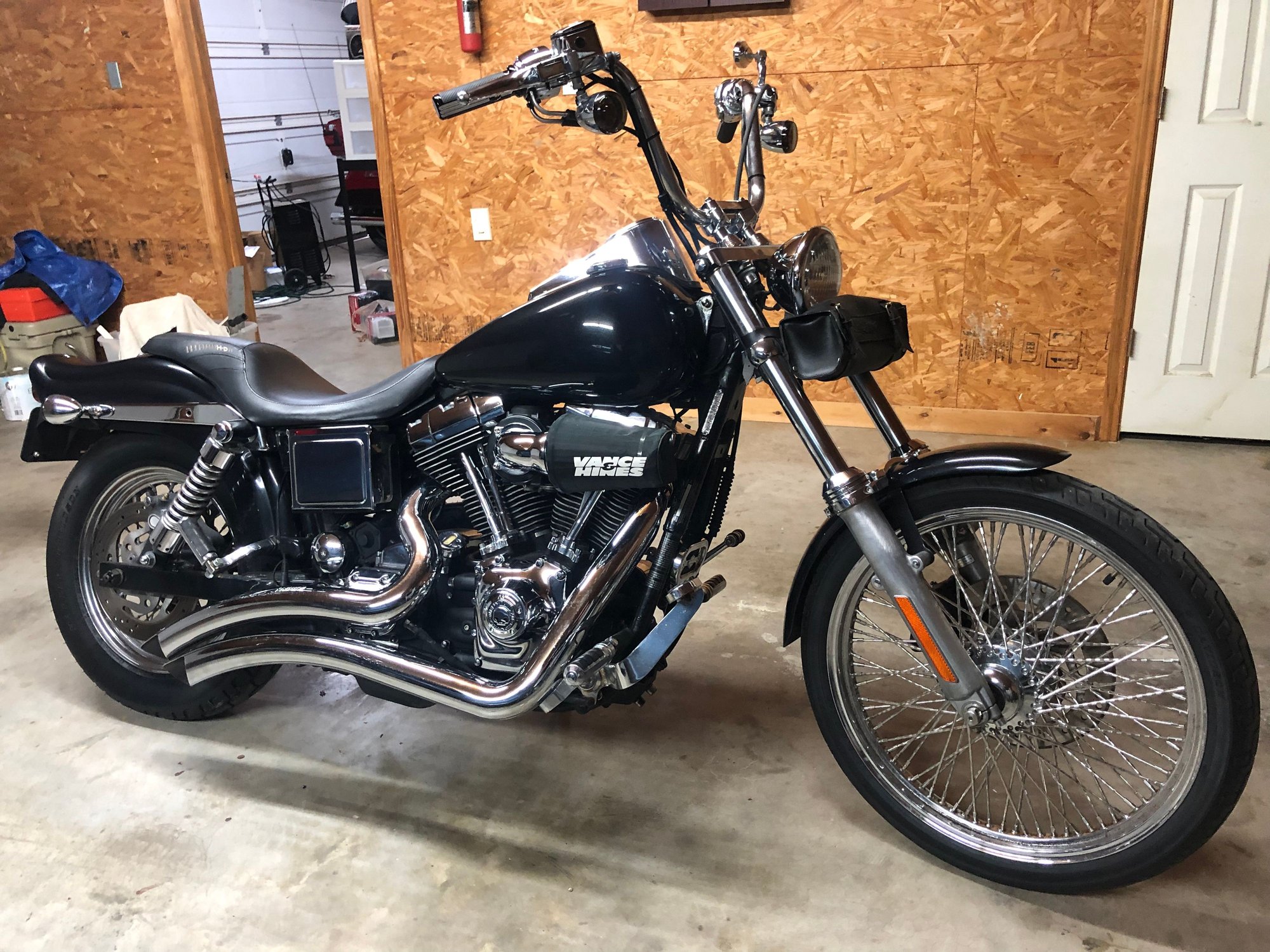

here is what I have done with mine yours looks great I have replaced the windshield with a new one
