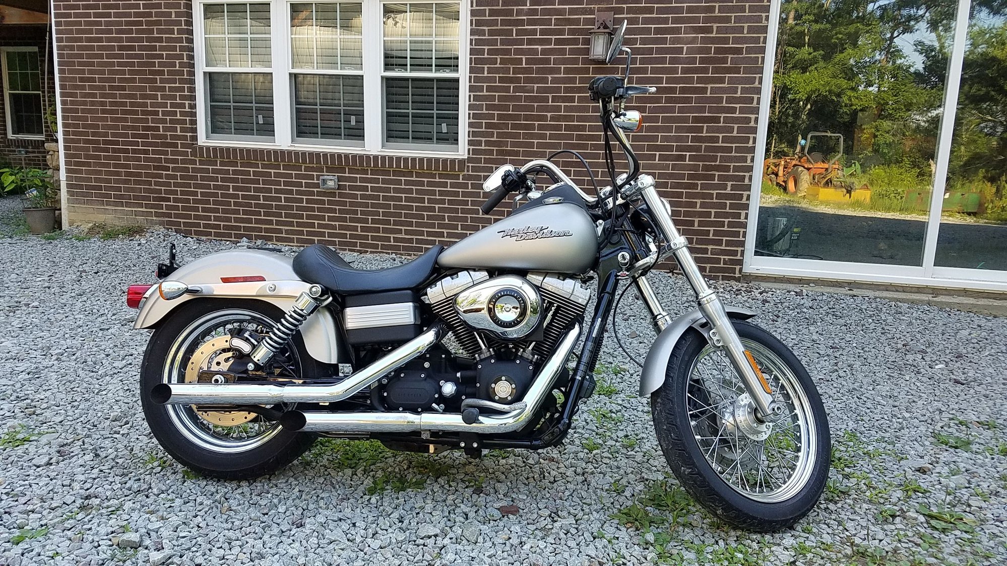

Starting a build on my 2008 FXDB. Got the bike last summer and it was stock:

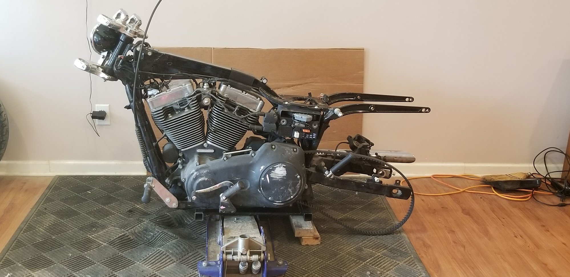

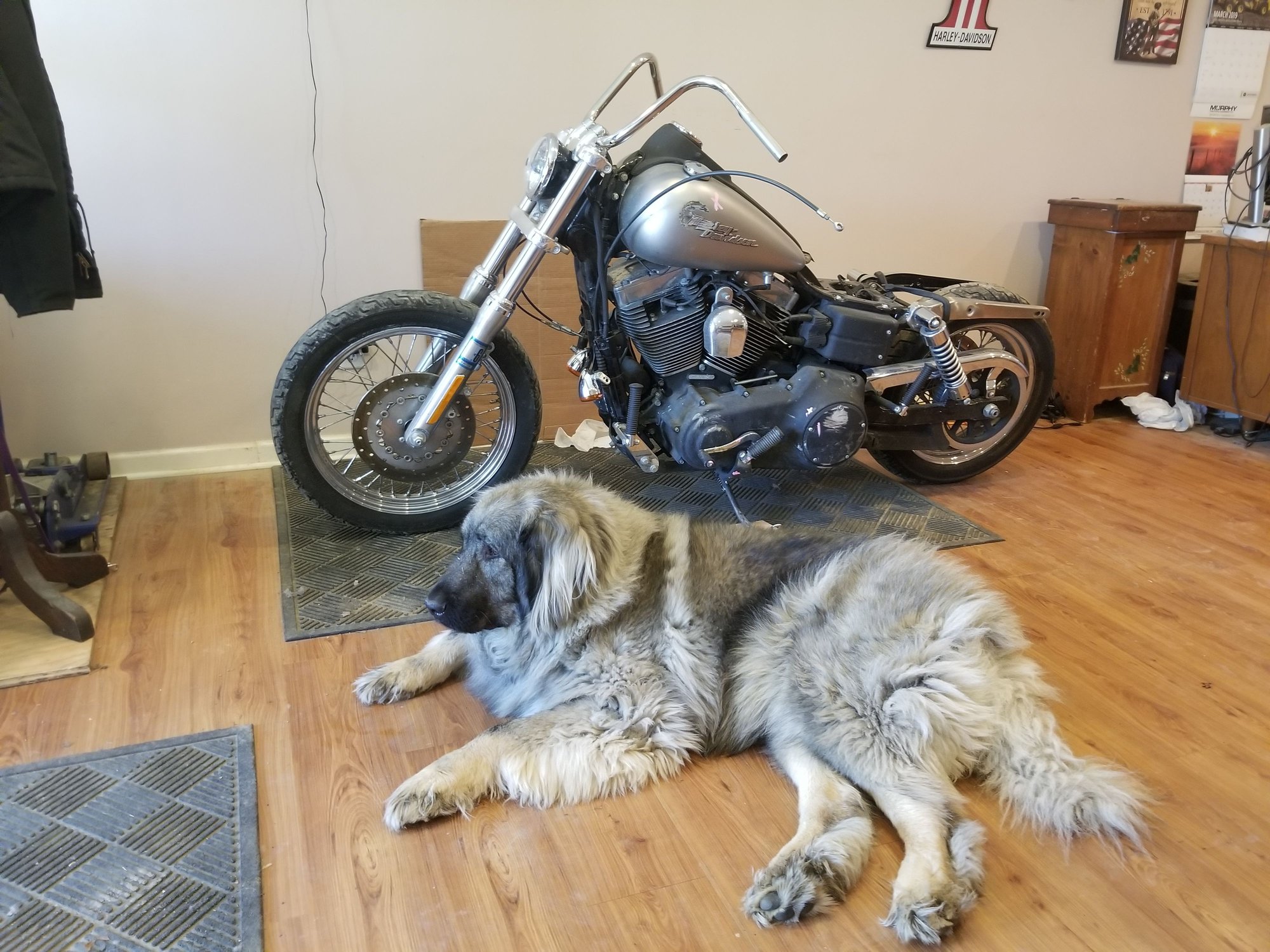

Beginning disassembly:

Current state - it's looking pretty naked now:

working inside the house, love it.

Taking a bike apart is a lot of fun!
It my office, in basement w/ walkout. Wife is used to stuff being in house that does not belong:
  • deer that got frozen thawed out in front of fireplace so it could be butchered
  • boar in bear fridge (stay cold for pig roast that was three days off)
so, in the scheme of things, a bike is not too bad.
