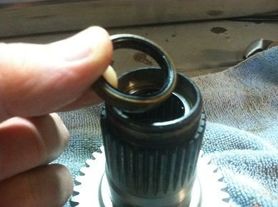

Mainshaft- Main Drive Gear oil seal (item 4), this seal is commonly overlooked, it goes into the end of the main drive gear and seals the space between the mainshaft and the main drive gear, very important to replace this seal (see pic).
