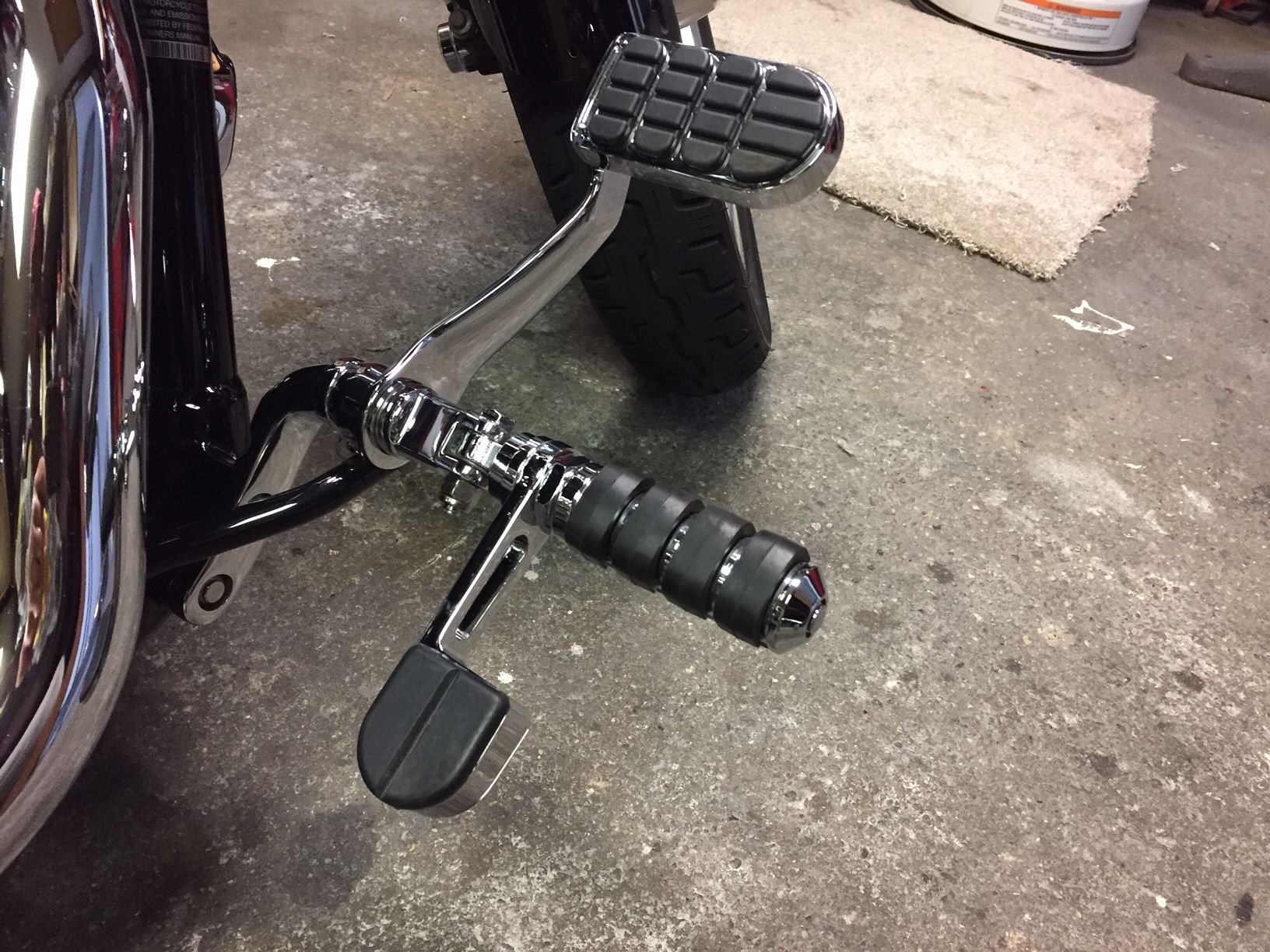

5'5", 150lbs, 30 inch inseam. I have the forward controls on my 2009 Low rider and at first it was tough to reach comfortably. The answer for me was to replace the tear drop air cleaner with a round one off a 2016 Street Bob and put the "stirrups" on it....I also took off the short brake pedal and put a longer one on.
Steve
