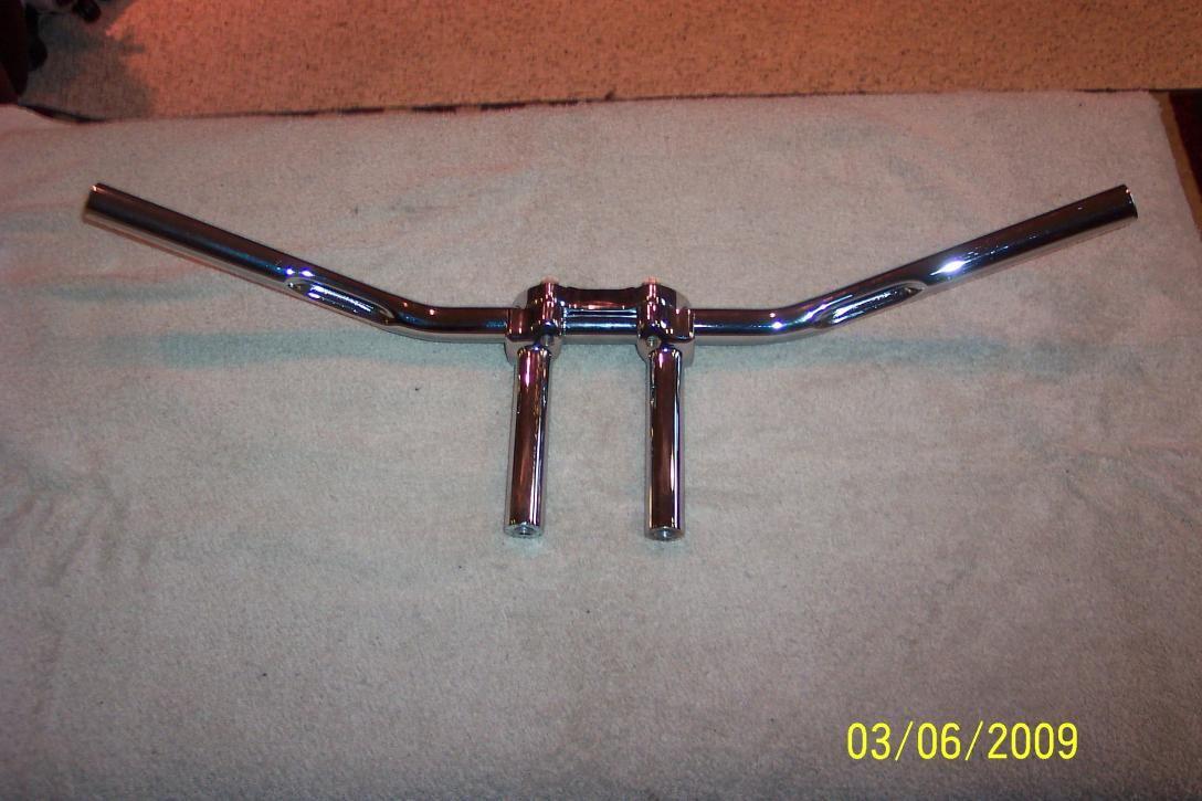

Would the DK handlebar riser extensions work to extend Nighttrain stock bars? I'm not sure that's exactly what they are meant for but I guess it would work to add another three inches. I guess I'm being a little tight waded but I don't want to spend $300+ on handlebars right now especially since I'm not certain what I want.
