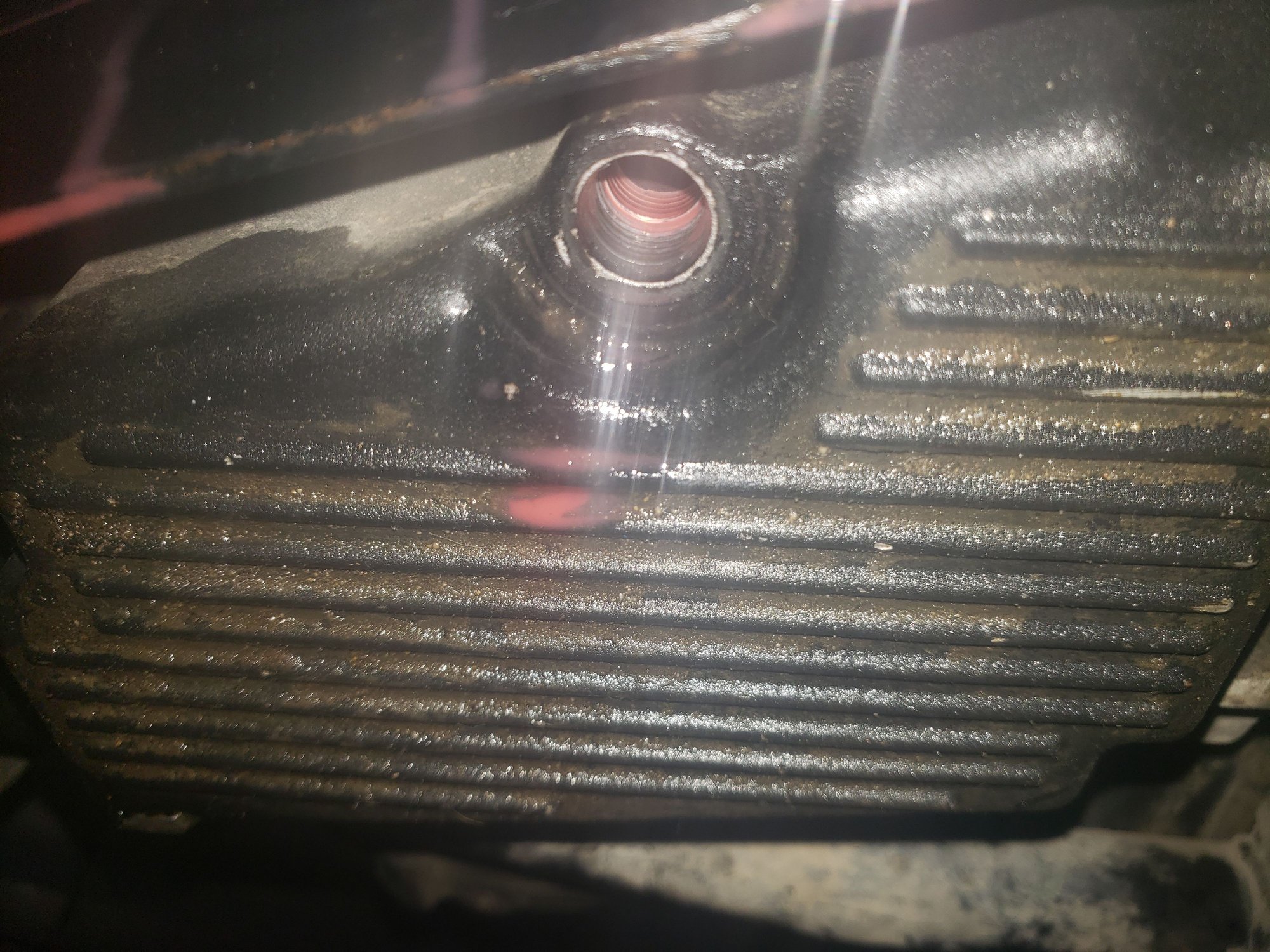

OK,
**** is piling up! As you can see from the photo below my trans oil plug hole is stripped, 6 threads from what I can make out!
I did some searching, and this (Dorman piggy back plug) is a common go to answer!
https://www.hdforums.com/forum/prima...l#&gid=1&pid=6
My question is, with missing this much thread, should this solution still work? or should go up one size? bolt (and tap)?

Apologies, I failed to notice the OVERSIZE on both the tap and bolt!

What about a helicoil?

Honestly, I would try just cleaning it up first. Run a thread restorer through it (not an actual tap), make certain the threads on the plug are good, put a fresh o-ring on it, and see if it seals.

id chase the remaing threads. new plug. wrap with teflon tape. whats the worst than can happen
