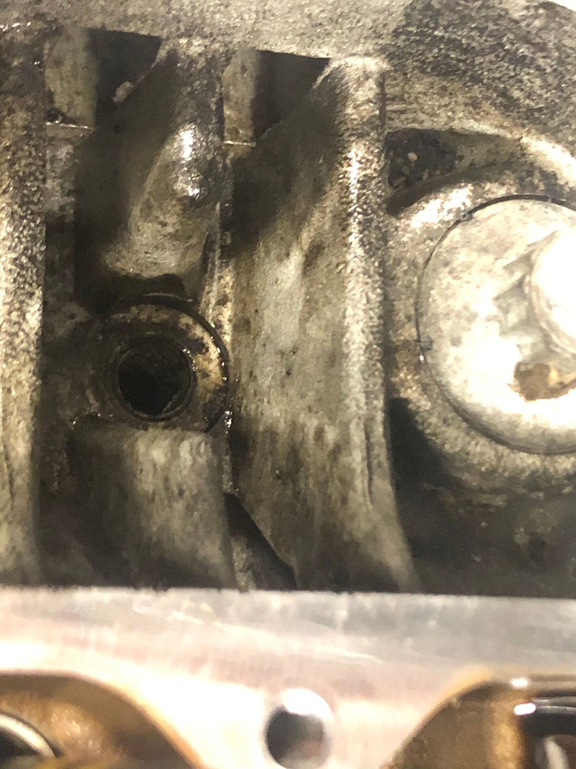

Ok Folks, I bought this bike a few years ago and started having a small leak in the front rocker box. Got the box off and see this hole that has threads that had nothing in it. Can anyone tell me what it is?

I believe the bolt for the breather threads there

It would help if we knew the year and model. On my 08 road king that's where the acr goes...not sure on yours.

A quick look around the net, EFI temp sensor? Head part number would be 16721-84, sensor 32446-95A

Its a 1998 Dyna EVo.

It’s an aftermarket head. The hole measures 1.3 inches in depth and the dealer mechanic says it is for a temp sensor.
