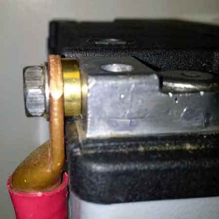

+1 on lock washers... Easy fix. But also, depending what brand battery it is, make sure the cable ends sit completely flat and flush with the terminals. Some non-OEM batteries require a small spacer between the terminal and the cable to allow for a snug connection. Without the spacer, the cable end may be slightly angled due to interference with the case (the battery terminal is actually slightly recessed from the battery case on some batteries). If so, I could certainly see them coming loose periodically.
The reason I prefer lock washers to Loctite is that it's easier to remove and reinstall the cables if needed, since you don't need to clean off the old thread locker and reapply...

Check for the brass spacers.
Wasn't any on my bike when I got it so I didn't know. It made the connections not flat. Melted the lead posts.

Previous battery was a Dekka which also had this issue and the new one is Duracell, which looks exactly like the Dekka in every way except the label. OEM never had this problem (I thought was re-branded Dekka?). Recessed terminal is an interesting theory I'll look into. Maybe that's the reason why I have to torque the thing down to about a 1,000,000/lb ft just to get a good enough connection. When I re-torque, the bolts don't even move a noticeable amount, but works every time.

This is a generic picture, but illustrates the issue. You can see what would happen without the brass spacers... The cable wouldn't be flat on the terminal, which can cause many issues. Needing to tighten occasionally would be the "good" outcome... Melting/frying stuff often happens. This is actually a very common issue, that's easily overlooked if not thinking about it. I'm honestly not sure why any battery would be designed with a recessed terminal, but many are. I may be wrong, but I think even non-OEM Dekkas may be like this! And I'm pretty sure I've seen people call out Duracell for the same issue, although I may be wrong.
