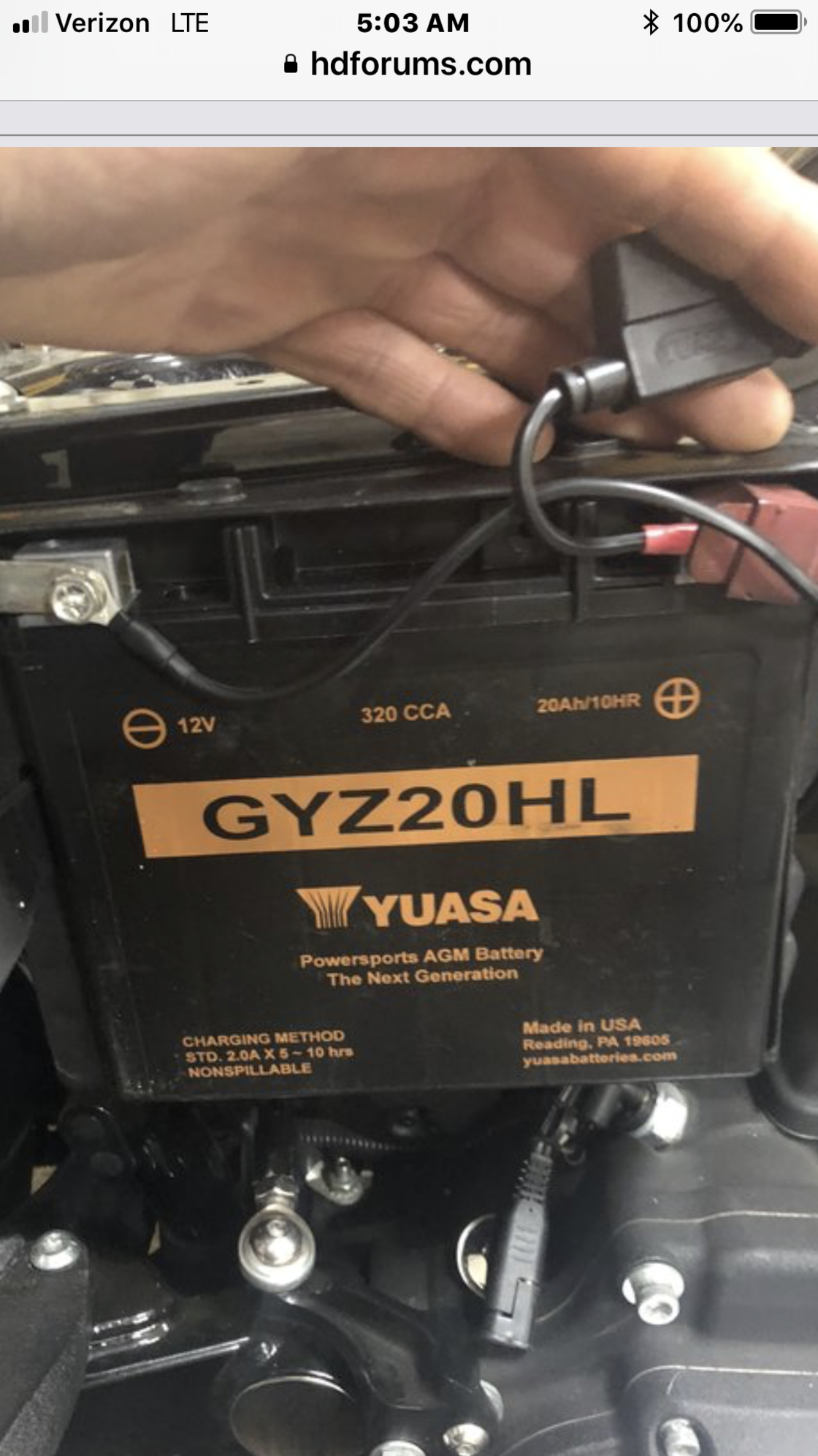

So i ended up getting a yuasa battery ordered from online through revzilla. I initially bought a bettery from autozone but i decided against it due to the horrible review. I got on a paymeng plan w revzilla since cash is tight right now.

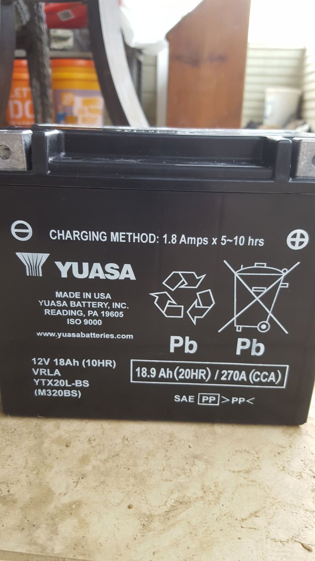

I got it in and i just had to add the acid then charge it. It instructed to use an automatic charger w a maximum rating of 2 amps. Or for constant current charging, refer to the table which is 1.8a x 5-10 h just like what it shows on the battery. I did end up getting an automatic charger from autozone for 32 bucks, what my budget allows. Its automatic w a 2 amp rating. It finished charging around 4 hours. So hopefully thats a good time and not to fast of a charge.
All that is left to do is go get my bike from my works parking lot. Then when i have the time and I will check the charging system. Which is honestly foggy to me and unclear. Maybe when i hot the cash ill take it to a shop. But id much rather learn myself.
Thank you for the input and advice. Lets see if this bike starts up. To be continued....

I went with this yuasa. 320 cold cranking amps.

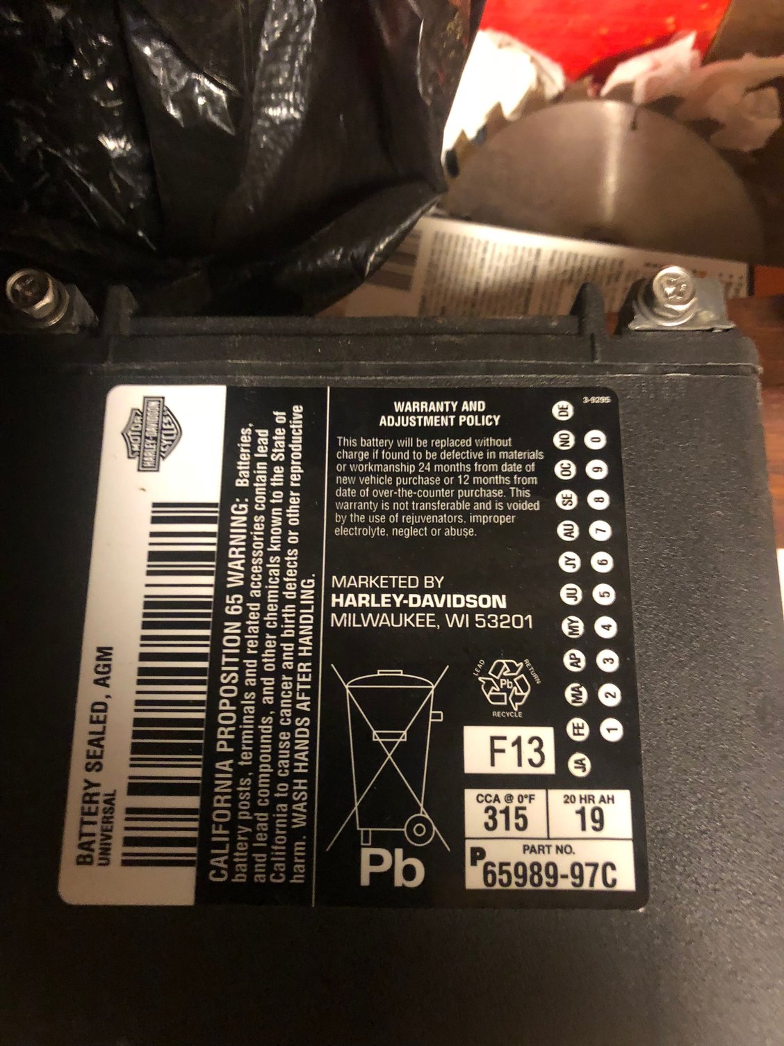

The stock battery in my 2012 dyna was rated at 315 cca. The battery you bought is rated at 270 cca. What was your stock battery’s c.c.a ? Probably won’t be a problem in California lol!
Honestly i didnt even think to look at the cca's on my stock battery. Rookie mistake i guess. Lol. Well between this battery i got and others available through revzilla the guy said this runs better in the cold...well compared to the lithium battery. And i do ride in the cold. But the coldest it gets here is 30 degrees and above. So i hope thats efficient for here! Where do you live if and how cold does it get over there?
so i did end up getting the bike home that day of my last post. Took a late night trip and installed the battery. Was heavy on my mind. It started right up. 2days agos that was. This morning i realized that i prob didnt put the bungee strap on the battery to secure it. So i check it, sure ebough its dangling outside the battery cover box. Another rookie mistake lol. Gotta say, its started right up! Sounded great, felt great!
The only issue i have w the battery is, it is a tight fit! I had to push it in there w some bit of force. Its a lil concerning but not to much. Just wouldnt want the houseing of the storage area to crack. Anyone else have the Yuasa YTX20L-BS AGM Battery in their dyna and its a tight fit? Overal glad to have her back home. Happy holidays everyone!
