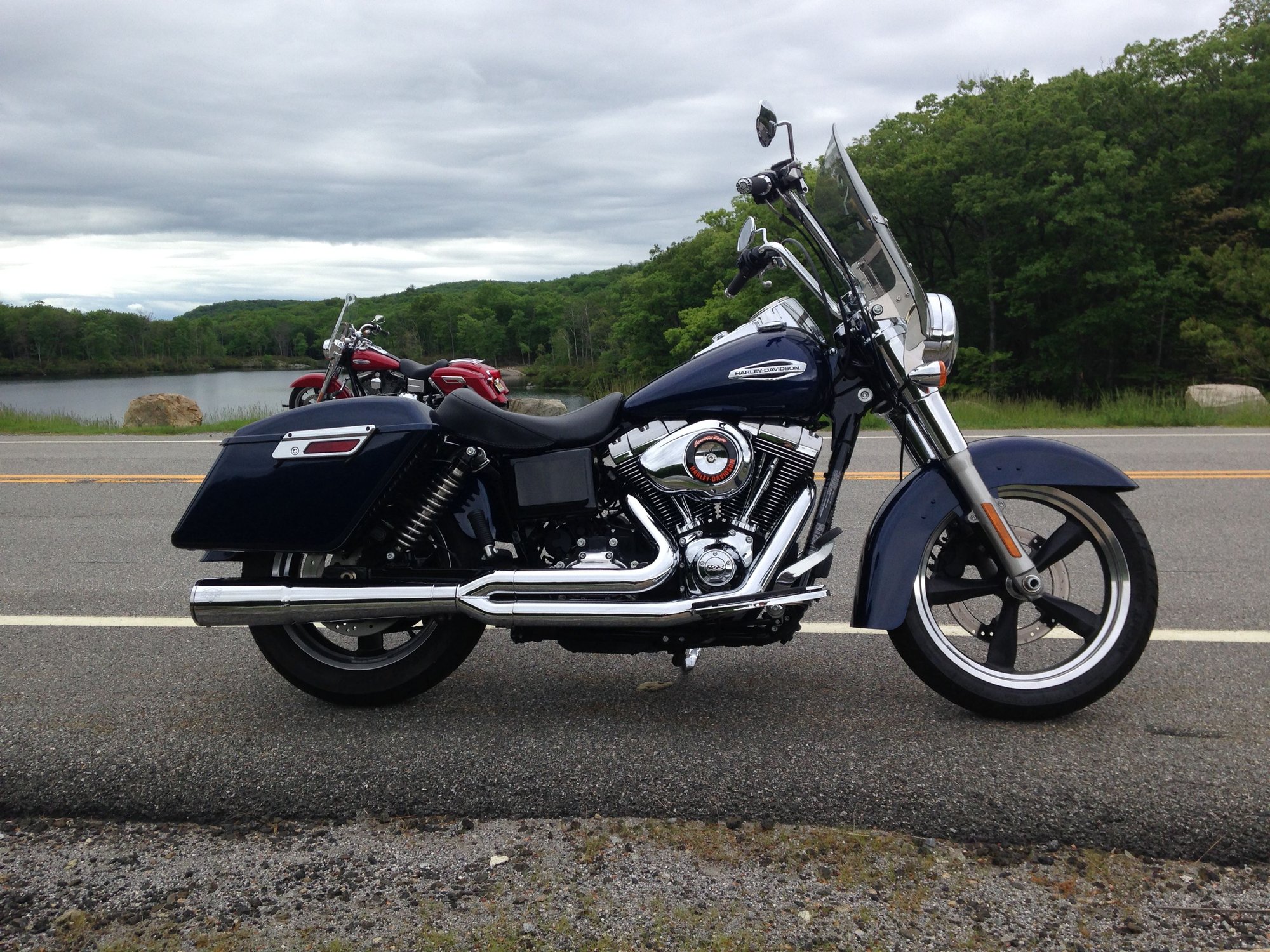

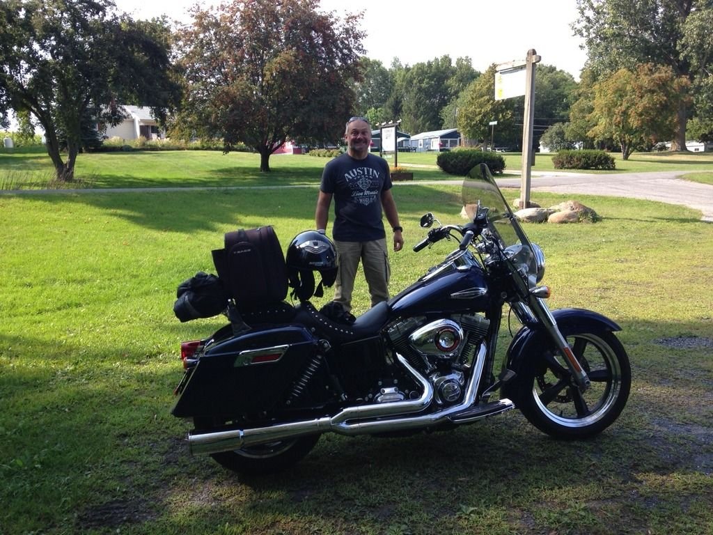

Greetings,
My wife and I both have Switchbacks that were bought new in 2013 ('13 models). We both love our bikes and they are excellent solo tourers. The price seems about right. Some Switchback specific things.....
Vibration - If the bike has the stock exhaust, chances are you'll experience heavy vibration in the 2,800rpm - 3,200rpm or so. This is not your normal Dyna vibration, but something specific to the Switchback. 2 ways to alleviate this. Google the "Clevis Pin mod for Switchback", which keeps the standard exhaust and uses about $5 in parts (yup, a clevis pin is among the parts). This takes the vibes down to normal levels. The other way to reduce the vibes is get an aftermarket full exhaust replacement. My wife's bike has the Clevis Pin mod and I have a full V&H Pro Pipe exhaust. Vibes are gone.
Heat - If the standard header/exhaust is on their, it will product A LOT of heat from the catalytic converter on the right side of the bike. This can be alleviated with an aftermarket full exhaust, or by getting HD's Heat Deflector. My wife has this on her bike since she has the stock exhaust. She said it reduces the heat by about 30+% or so. Previous to the install of this, I had witnessed her get blisters on the underside of her thigh from the heat. According to the wife, this has reduced the heat enough to not be an issue. Edited to add: I just looked at the link you provided and it looks like the stock exhaust.
Suspension / forks - The forks are 41mm and are from the Softails of the era. One side has a damper rod, and the other has a primitive cartridge. The travel length is just under 4". On both our bikes, I've changed the fork springs to Racetech single rate springs for our weights. Mine also the their Gold Valve Emulators. Makes a world of difference. The stock shocks are 12" in length and have 2.1" of travel (really short travel length). I've upgraded our bikes with aftermarket suspension using 13" shocks with travel over 3". Again, makes a world of difference.
Stuff - IIRC, the lean angle is around 29". I used to scrape the floorboards all the time. Now, with the 1" longer shocks, it's rare that I scrape the floorboards. Things like mounting brackets for the sissy bar and what not, are Switchback specific. Seats are generic Dyna fitment. Exhausts are Dyna specific with an additional spacer for the floorboards. There are some Switchback exhausts out there, but nowhere near the selection of generic Dynas. If you can find the floor board exhaust spacer, you can use just about any Dyna exhaust. Watch out though if go with a longer shock. You wind may wind up bumping the underside of the bags with the exhaust if the shock length gets above 13.5". Speaking of bags, make sure you lock them if you ever remove them. I lost a bag going over train tracks from not flipping the switch that locks them in. $745 mistake.
Seats - I'm 5'11" w/ 34" inseam and found the stock seat scrunched me up by being too low and too close to the tank. Not to mention, the padding was minimal...it sucked. I've experimented with a bunch of seats (HD Tall Boy, HD Sundowner both solo and dual, Corbin Classic Solo and pillion, and Mustang Wide Touring w/ backrest), and still haven't found "the one", but the Mustang w/ backrest gets me closest (lifts rider minimally, maybe 1/2" and back 1/2 - 1", still want more up and back though. The Tallboy is actually really good if you like being "on" the bike, but is a dramatic repositioning where the windscreen is then producing turbulence (lifts rider 2" and back 1.75"). If there was a backrest option for this seat, I would go with this and get a taller screen (already running an LRS 18" curve....stock screen height is 16") The Corbin is beautifully crafted and sits you "in" the bike, but is rock hard and transmits every ripple of the road (lowers rider by at least 1" and back by about 2"). It is the only seat I know that actually locks to the bike and the backrest locks to the underside of the seat, vs being able to pulled out without tools as on the Mustang. The HD Sundowner solo is what my wife runs and works very well for me also (lifts up 1" and back 1", not to be confused with the Sundowner Dual, which moves up 1" but forward 1"). One thing I really don't like about the Sundowner solo is how it attaches to the pillion. It uses a plastic tab that is really flimsy.
All in all, my fav' bike that I've had. It's like a Road King light, and I like that they aren't too common. I've upgraded cams, Stage 1, shocks, forks, seats, bars, etc. The best upgrade was the suspension. Longest ride was from Asheville, NC to Bergen County, NJ in 10.5 hours (710 miles) and the bike did well. I ride about 4-5k miles/year. Am at 22K now, and no issues.
Good luck!

Thanks for taking time to comment and provide a detailed write-up. Nice SB you have there too. My thing is, I'm really trying to avoid doing a lot of mods. This will be a secondary bike for me so I'm not interested in putting a bunch of money into it. A seat or shield here and there I don't mind but having to make extensive suspension and exhaust changes I'm really not interested in doing. Granted, the exhaust vibration fix sounds simple. And since this is secondary bike for me, it doesn't need to be set up for long hauls.
