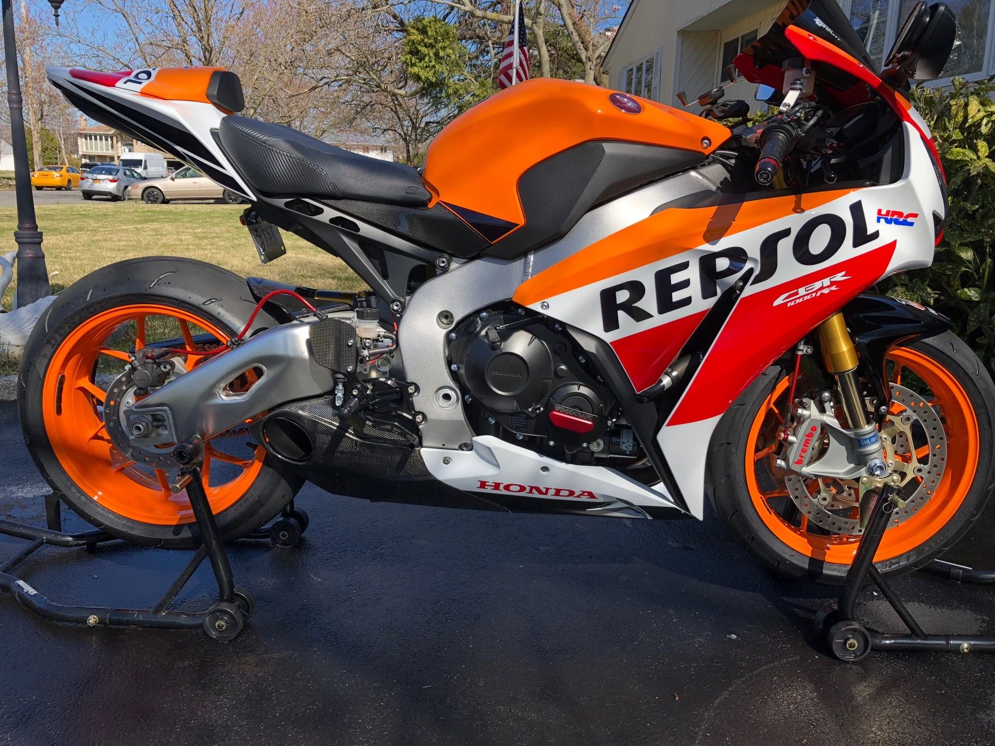

Originally Posted by F86
Me and the great Keith Code a couple of years ago... I've been lucky enough to have Keith as a coach a couple of times, which was a great experience!
I've done CSS a few times and Yamaha Champions School. Here's my other ride...
You folks are lucky to have tracks and schools nearby. The track here closed in 2010 and we sure miss having it.
