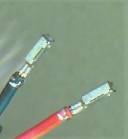

It`s a crimp connector, obviously it is designed to be crimped. Solder is not the way to install this connector.
You will never see a solder joint on an OEM connector. A proper crimp is the best way to install a terminal to a wire.
Yes Dan... it is a crimp connector, and after I crimp it, I would solder it, because it will be better. You don't have too!
To be fair to the OP, these are cheap, tiny connectors, not as good as OEM (see pic), and you don't need to buy a crimping tool to crimp these, if you don't want to.
